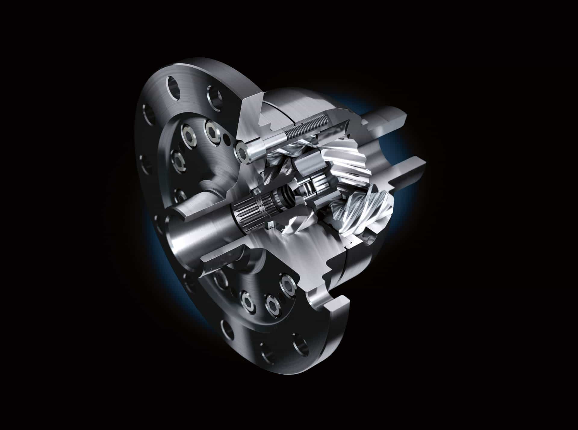

My perfect choice would be to have a Quaife ATB that way it would increase long term reliability and do the same job as an LSD but without the plates; a tad costly if an MX5 slipper is working as it should already but if I was racing I would be looking at the Quaife ATB very seriously (assuming they are available for MX5 diffs).
For those interested here is a worthy link:
