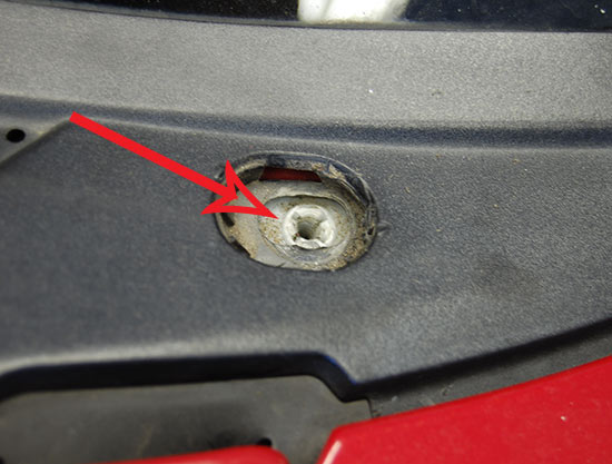

Either side at the base of windscreen black plastic cover panel (it’s in two halves) there’s a fixing screw under the cover caps, ease the cap off each side to reveal the screws (see picture below) these screws hold the panel in place each side. The screws fasten into the grommets mentioned above, it’s the gaskets under the grommets that dry out and then the possible leaks start and drip down into the cabin from under the dash. Passenger side leaks can drip down on to the small fuse box at the base of the A pillar and are known to cause electrical gremlins.
To get the black panel off or partially removed to gain access to the grommets you need to removed both wiper arms and lift the bonnet and remove the rubber strip along the bulkhead, this is clipped in, you can see how all this is fastened when you take a look. You can even disconnect the washer pipes for better access but I didn’t find this necessary. Once you’ve gained access to the grommets you can remove and replace or as I did clean the area up and use some clear silicone to seal around the existing grommets. Once done put it back together and for good measure replace the securing screwes with a blob of silicone too.
