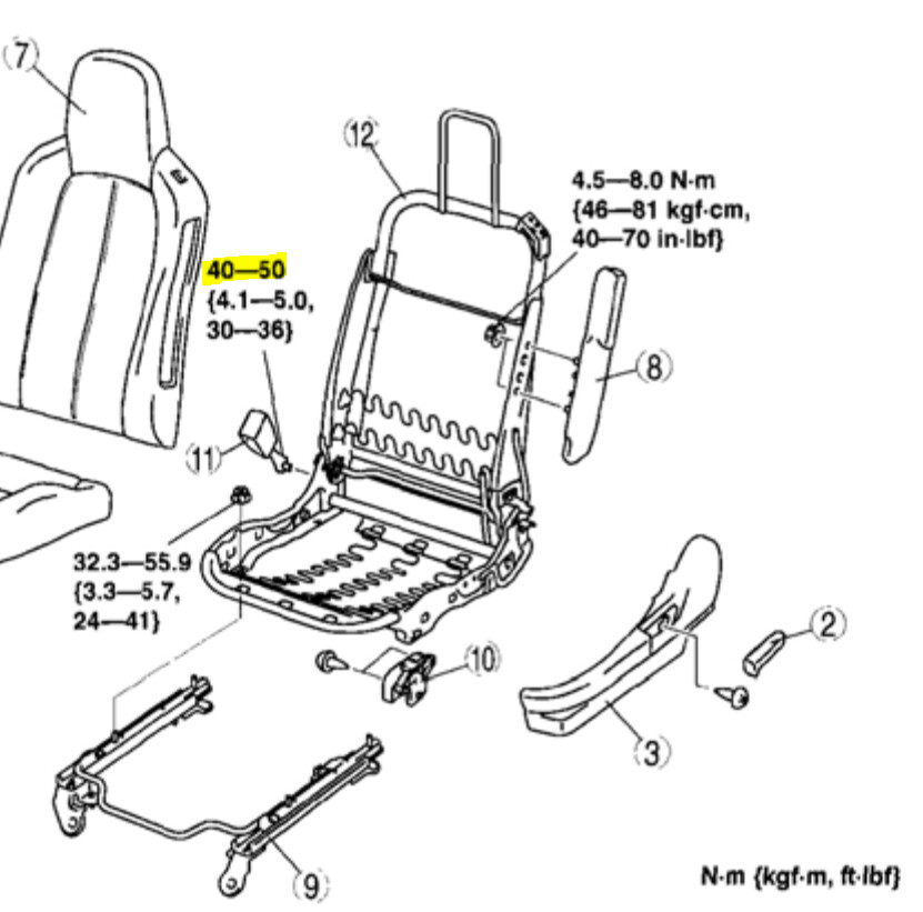

Looking to replace the drivers side seatbelt stalk/buckle as it only seems to be releasing maybe 1 out of 10 times when pressed down.
I understand the process for removing the seat and seatbelt buckle however i wanted to confirm if these torque settings that i found are correct and apply to the MK3.5 too and not only the MK3 (came from the 2007 mk3 mellens service manual)

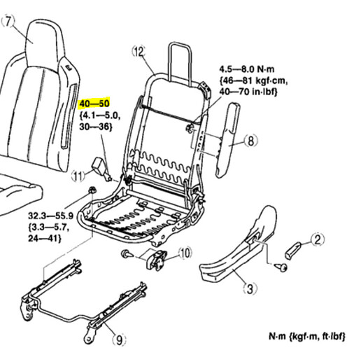

Seatbelt Stalk - 40-50nm?

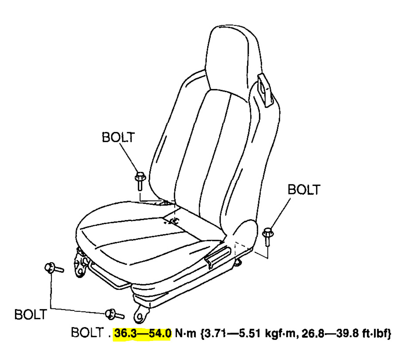

Seat fixing bolts - 36-54nm?
Do these sound right? Also would it be a good idea to put some locktite on the bolts or would this be unnecessary?
Thanks.
Sound about right to me, I wouldn’t Loctite the bolts.
Nothing wrong with using the BLUE 243 (medium strength) Loctite.
Can be undone with Torque (spanner/socket) quite easily. :+1::slightly_smiling_face:
