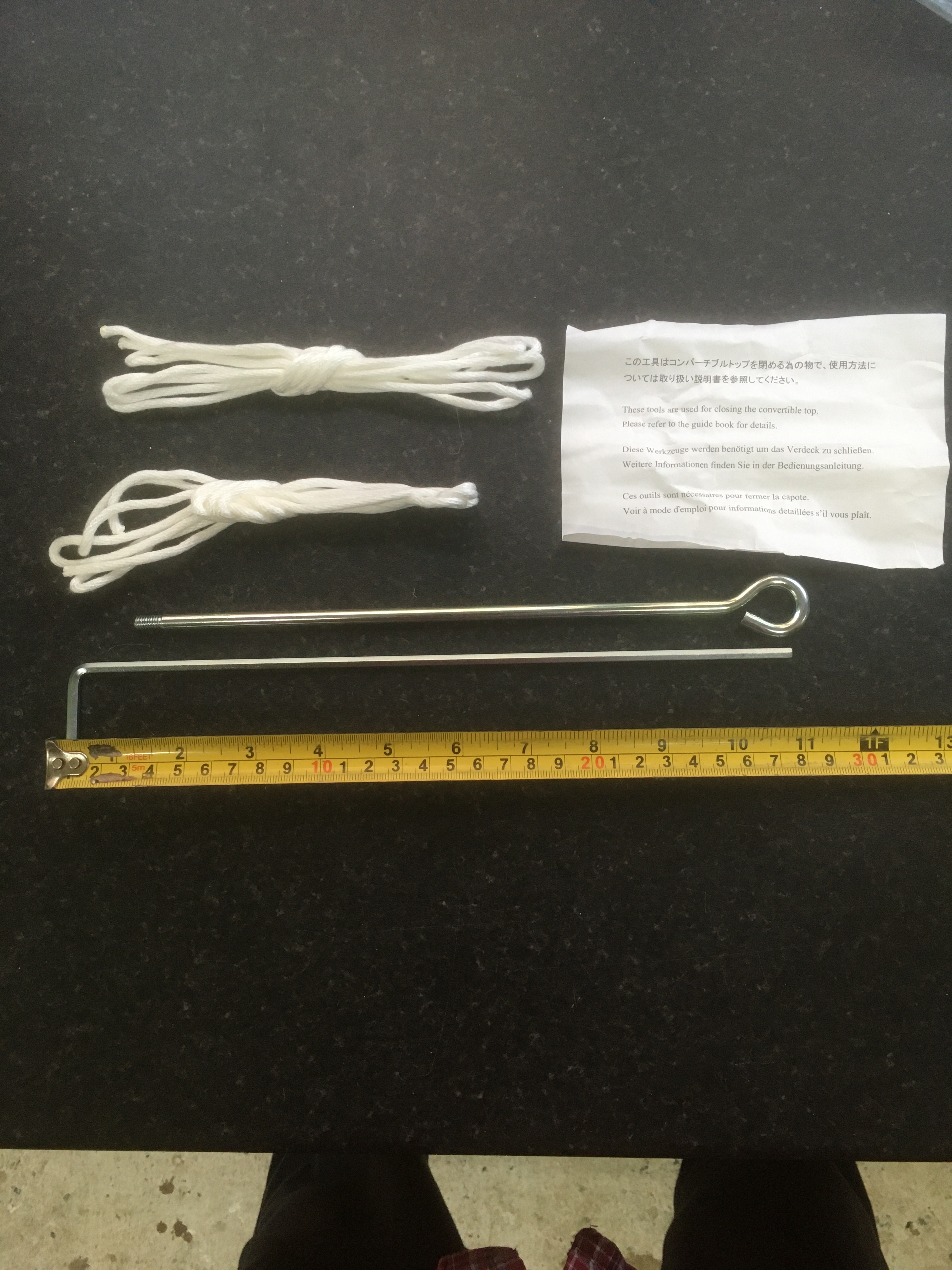

As promised anyway.
The screw thread is 6mm.(Typo 6mm is correct)
The allen size is 4mm.
Easily made if you get stuck.
Picture for the approx sizes. :+1:
Eye bolt is 250 mm long from eye centre to end of thread and is threaded 15mm in length of 6mm x 1mm pitch.
Allen key 4mm at 275mm long.
Rope is approx 750mm long 3mm or 1/8" nylon.
