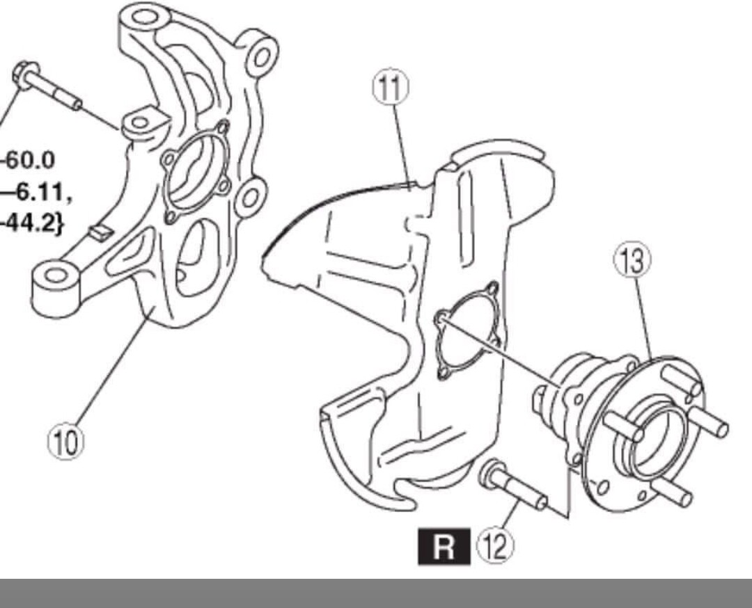

Afaik the front bearing hub assembly is an integral assembly with no facility for dissembly. There are different part numbers for abs and non abs hubs.
It has ABS…all cars have ABS since 2004.
As above. ABS and traction control and dynamic stability control are different things. You can turn DSC off on 2l cars, 1.8 does not have it to turn off.
Front is inside the hub as per the pic, rear is old school style - a caselated ring on the CV.
