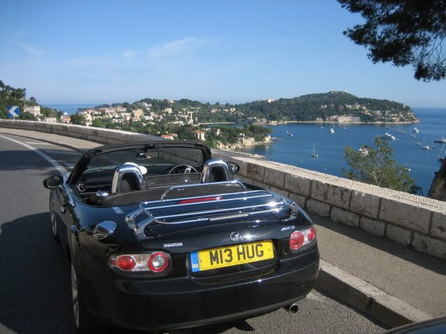

Rubber feet - yes, that’s what I meant. Hand tight with the allen key saw our rack with luggage down from Nottingham to the Centre of France on two occasions, and a shorter trip to Reims in between. No problems, the rack is solid as a rock. Never had cause to re-tighten anything. It was also empty for a week before, during the stay and at least a week after returning.
Our boot rack has been to France, Italy, Andorra and quite a few other places with the bolts just hand tightened with the Allen key. It has never worked loose or slipped.
Here it is on our previous car just outside Nice.
