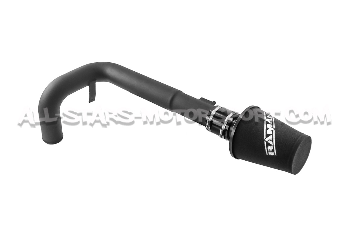

Mk3 cai, worth it for the subtleties?
Hi, I was thinking about getting an after market cold air intake for my mk3. Ive done a little research on it and found mixed responses. I wouldn’t be expecting too much from it just a slight improvement in throttle response and a bit of induction growl, also it seems like a good place to start if I wanted to do any exhaust mods later on.
The only thing that stops me from just getting it is I’ve seen a lot of stuff saying the stock filter is good enough and that it wont offer any worth while performance gains and the money is better spent elsewhere.
So i guess the question is should i get it for the subtleties and modification future proofing or find something more worthwhile to spend my money on?
Also, if anyone is in the pro-filter team, any recommendations? Bare in mind it would have to sit in the engine bay or behind the bumper, behind the grille is too low for the area i live in, no “floods” so to speak just a likely possibility of deep puddles!
If anyone is in the no-filter team, what should i get instead?!
Thanks in advance for any replies its much appreciated
Disclaimer: I potentially have no idea what I’m talking about so please take that into consideration before you roast me for stupidity.

I’ve seen a few people recommend the skuzzle, it’s hard to find online though I’ve seen 1 I’ve got me eye on and the company seems to have shut down. I found one by ramair that looks identical, would you know if it’s the same? The skuzzle uses a ramair filter from what I’ve seen so I guess they now use the skuzzle design
I’m not too sure but it’s very much possible that ramair made it for skuzzle after skuzzle did the development, normal practice in business. Even ramair, when they make them they only do a few at a time and they all sell out rapidly.

Yes Skuzzle designed it and Ramair produced it initially with the Skuzzle name. Now has the Ramair name. Nick from Skuzzle funnily enough bought my one from them.
Direct from them £157.50.
Ok cool thanks guys, I think I’m going to do it, I’ll take the plunge and get the ram!
Saw a skuzzle on eBay for 250 glad I waited and asked the question on here, £150 is much better!
