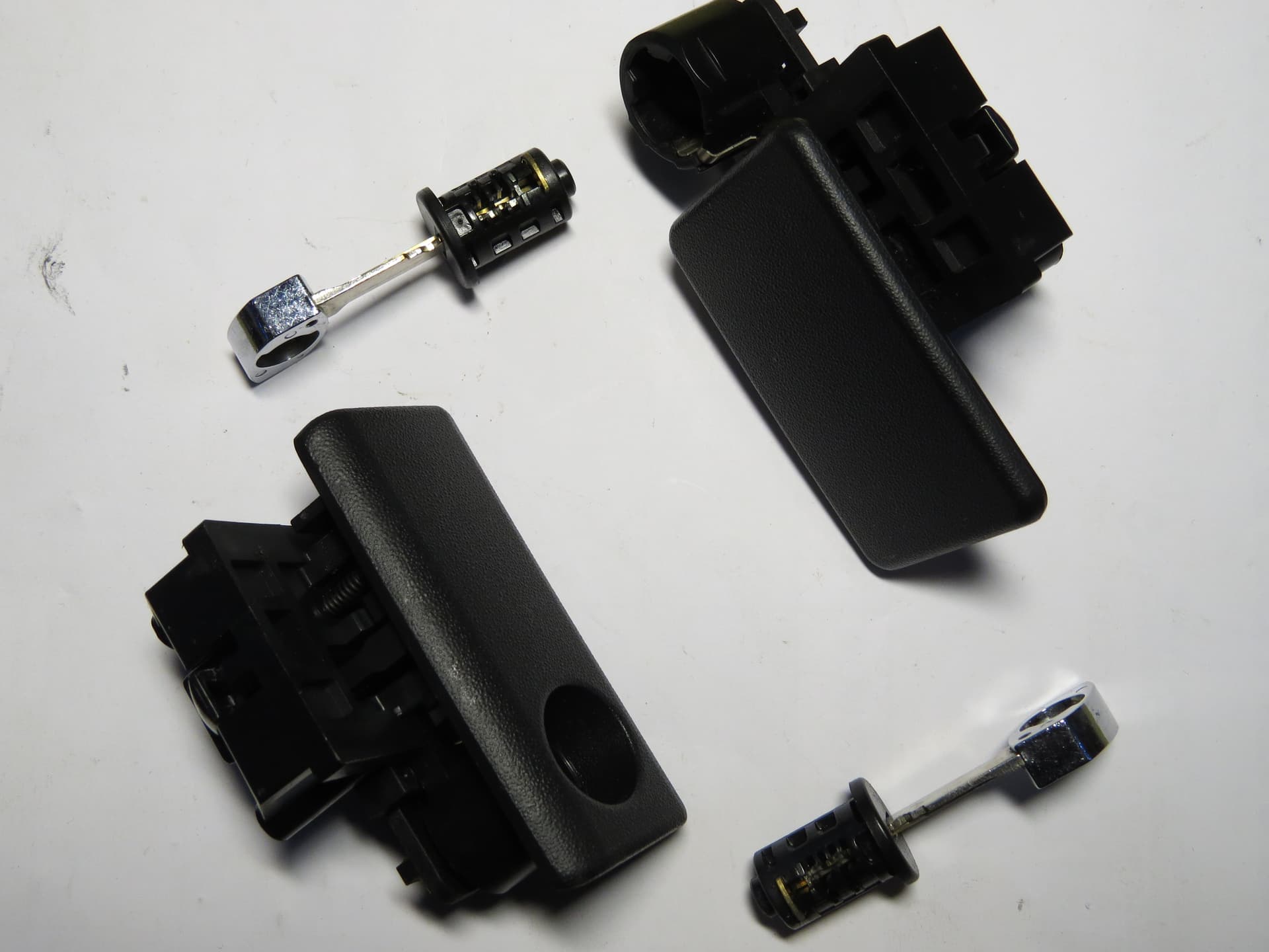

I’ve been playing around with MK1 and MK2 locksets for years, reconfiguring to fit keys, repairing, etc. Not much experience of the MK3 but recently took the internal locks off both a 2006 and 2010 apart. They are both exactly the same and I was shocked - see photo.
Hopefully clear enough for you to see that there is only 1 wafer fitted to both glovebox and console lock mechanisms standard, as opposed to four and sometimes five to the MK1 and MK2 internal locks. Door locks, boot locks and ignition on the earlier MKs have 8 wafers. These wafers centralise when the correct key is inserted to allow lock operation with the correct key or conversely non-operation with the incorrect key.
The single wafer fitted to the MK3 internal locks is nothing more than a gesture, making them generic. They will not only work with all MK3 keys but also with all MK1 and MK2 keys as well. Quite handy if a replacement needed but about as useful as a chocolate teapot for security.
The good news is that they could be fitted with springs and standard MK1/MK2 lock wafers to do the job they should have been manufactured to do.

I really wouldn’t worry about this ckleanth, well certainly not on my account anyway. You do not need to be a master thief to break into a locked glovebox/console; a child with a screwdriver would suffice :grinning:

I just cannot see the point of Mazda fitting impotent locks to the MK3; why bother?
Either fit proper locks that at least make some effort at being fit for purpose or abandon the idea altogether.
I gotta be honest. I am disappointed at how ■■■■ the center box (where the fuel flap trigger is) lock is!
if someone wants to siphon the tank that lock isn’t going to stop them!
I have been thinking about looking into upgrading that lock and it’s handy to know that it is possible!
