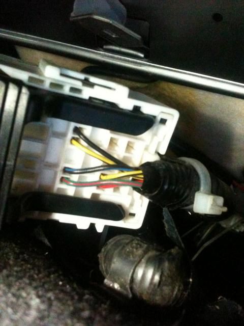

Hi Darran, here’s the white plug under my seat. It has airbag and heater and the wire colours look like green, blue, pink?, brown, blue/red.
The yellow sleeve goes from the plug into the seat. The black convoluted sleeve goes towards the centre console,
That pic is of the right hand seat and the green wire may tally with the circuit for the right seat heater.
Have a look to see if your right seat has it, and a green/red wire for the left seat like the circuit above shows. (I couldn’t open my left door to check as it’s in the garage.)

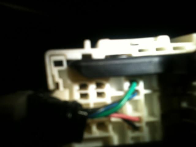

Hi rich here’s what it looks like under my seats I’m I in luck
Happy days, looks like you’ve got the heater wires already installed :slight_smile: I’ve just checked my RH seat wires against the circuit diagram and the brn/wht and blu/red in the pic are the airbag ones (which explains why yours hasn’t got them) so if you have the heater switch plugs behind the ciggy panel all looks good!
