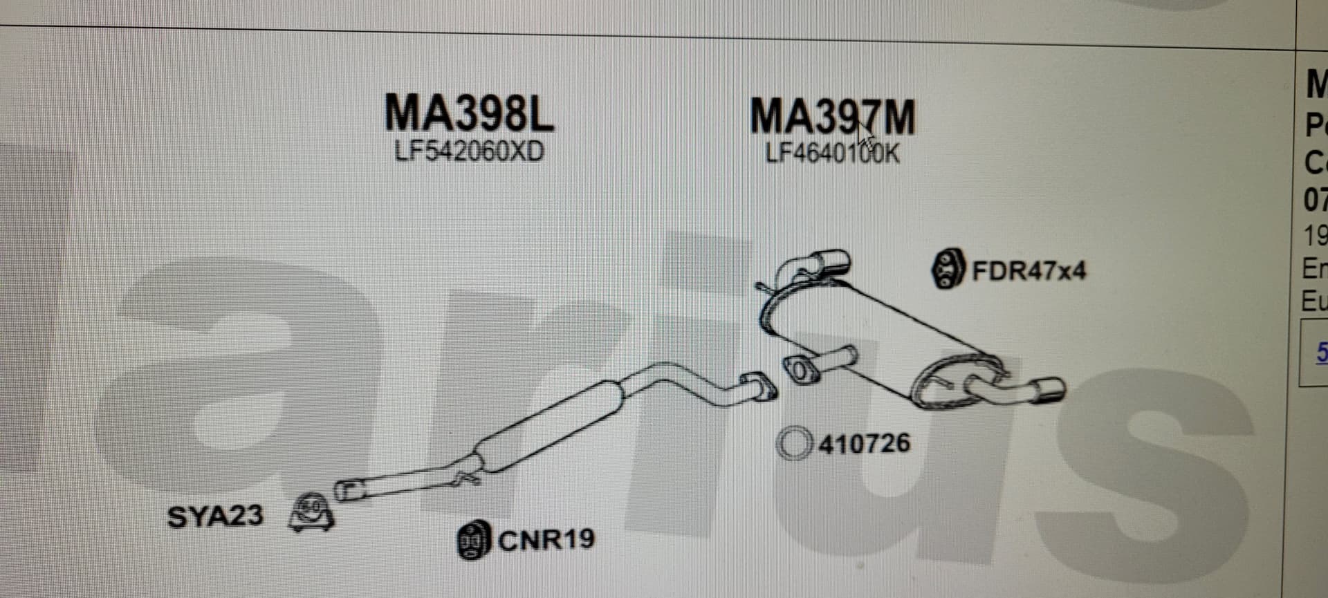

If it’s this part MA398L its ready available from yout local motor factors who sell Klarius.It should be around the £60 mark

It’s not this part but I have seen these, the one on mine is the short repair section where the original pipe from the cat through mid pipe has been cut and the repair section sleeved over, do you think I could remove my old section and disconnect the original pipe from the mid pipe and fit one of these.
