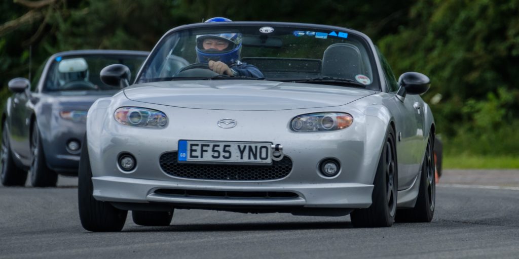

I fitted the Mazdaspeed Springs, no loss of ride quality. Big improvement
I also fitted RX8 anti-roll bars (yellow dot) These can be had for less than £100 a set. It now corners with very little roll. If you look in the Motorsport gallery you can compare the roll of others
