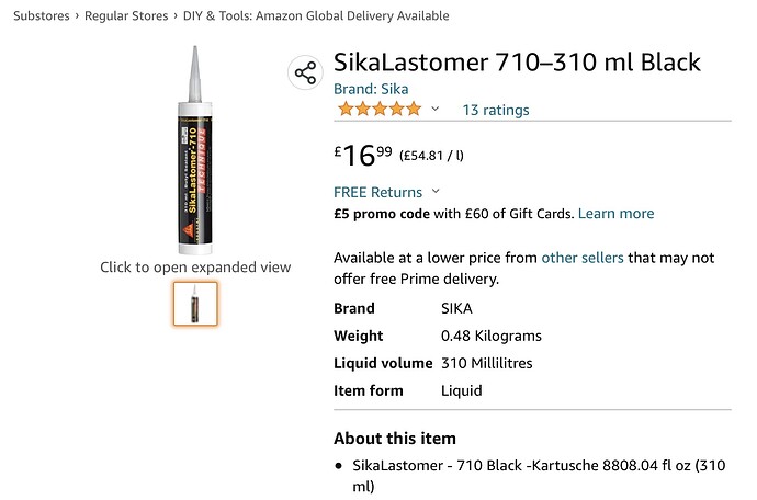

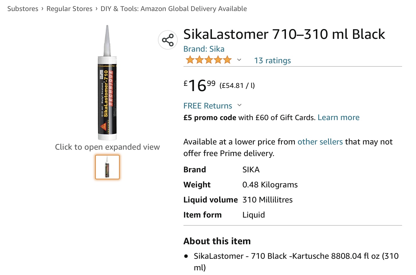

This is probably your best option.
There’s YouTube videos covering your problem too.
Thanks for the feedback.
Yeah I saw a video on YouTube (this one)of a guy repairing his with that, it looked like it would be impossible (or at least difficult) to remove the lights in future though. Also he didn’t seem to remove the old gasket before applying - not sure how well that would work as mine is covered in 14 years worth of dust and muck.
With how often the Mk3 seems to have this issue I’m surprised that there isn’t a gasket available.
You’d need to carefully clean your gaskets with a soft brush and apply the sealer to the bodywork after cleaning that. The beauty of this product is that it does not stop you from removing your lights in the future. As for NC1 issues…I had my tail lights out over this winter to do some work and they were almost like new, and my car is an ‘05/Launch Edition. So I can only presume it very much depends on how the car has been treated during its life.
Thanks, that sounds promising. I haven’t had much look with finding gaskets that will fit so I’ll more than likely give this a try.
