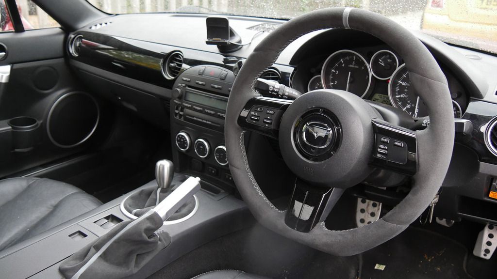

Got this for my NC1 from Guardian and it’s a NC2 wheel with the cruise controls. Means if I upgrade to a later model NC I can take it with me. Cruise controls don’t work, obviously, but switches light up when the lights are on.
MX5 NC1 Steering Wheel
