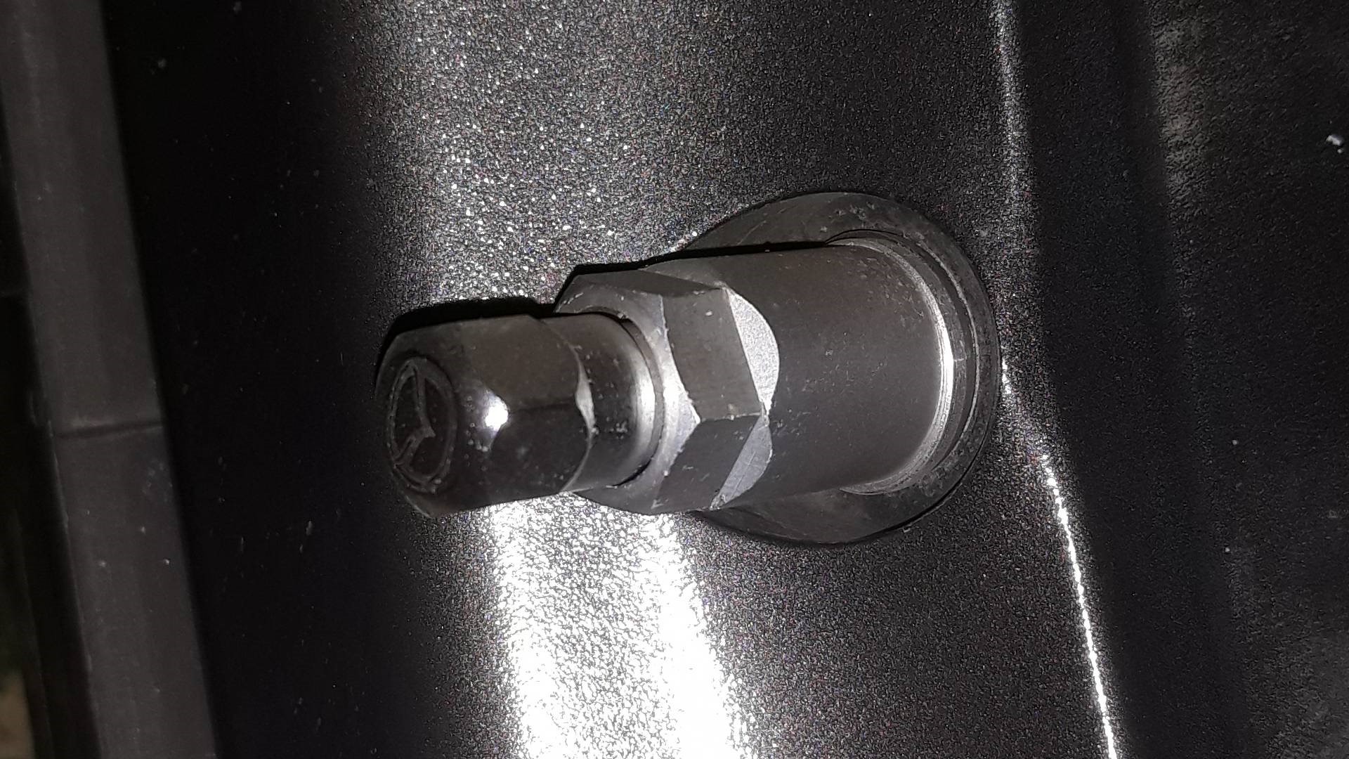

Another possibility comes to mind, but it depends on what Tyre Pressure Monitoring System you have.
It might be using the ABS sensors (and then have rubber valve stems), or like my 2014 NC3.75 the wheels might have TPMS valves with metal stems, as in my pic.
Now the crucial point, hypothetical, but a possibility depending on how the ABS etc software has been set up.
If the valves are the sensors, the battery life in them is about ten years (mine were still working at ten). Your car is eleven years old and bound to have had the tyres changed by now, BUT if originally fitted, were the TPMS valves also renewed, often at about £60 each wheel?
If one or more valve sensors are barely working, or dead, then there could be a logical conflict with info derived from the ABS sensors, hence confused lights on the dash.
A hand-held reader exists which can interrogate each wheel to find out about the status of the TPMS valve. It’s a faff to use but I’ve recently seen one working.
And one other possibility, are all the tyres the same make and type and size and age?
