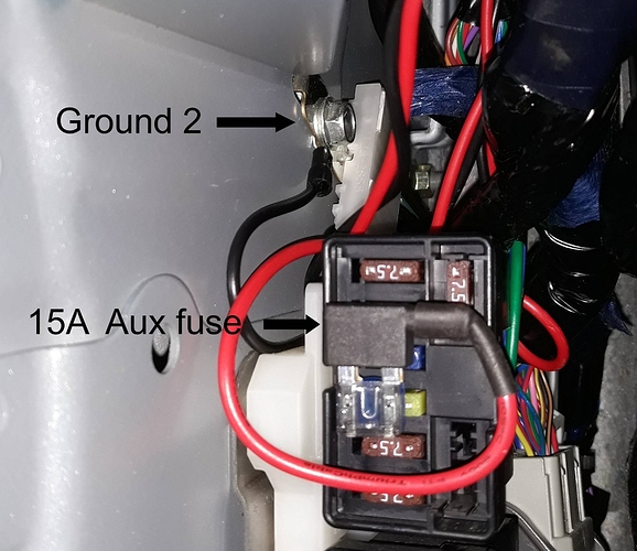

Footwell is the place to tap into for dashcam. The fuses are normal mini APM/ATM.
Engine bay box fuses are low profile mini APS, but normal mini APM/ATM will also fit.

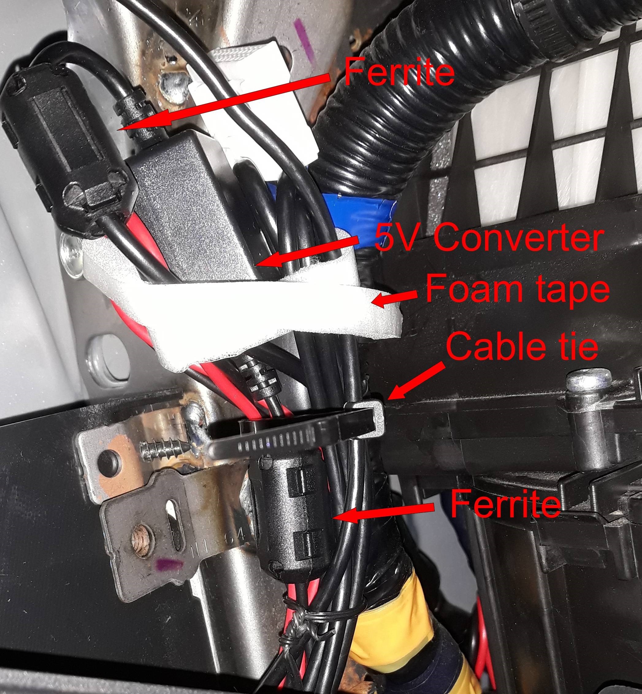

It is worth adding extra ferrites either side of the 5V brick to preserve the DAB and FM reception.
