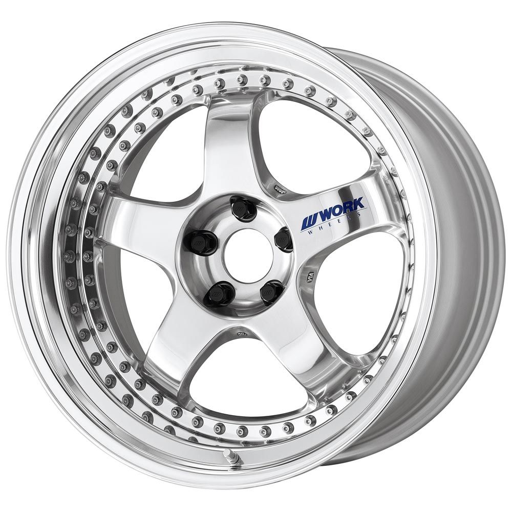

Sorry about the thread revival - What about these, not cheap but Driftworks assure me they will fit over the Brembos, after getting in touch with them. Just waiting for them to confirm specs and price.
Work Meister S1 3P Wheels
Usually quite heavy those works wheels
Ahh they don’t quote weights, but just go on about how strong they are.
