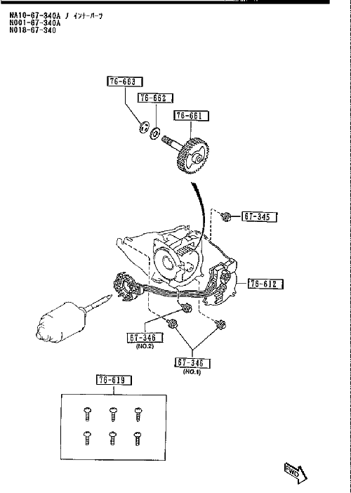

There are several different types.
For the 1994 1.8 alone, there are 3 versions
N018-67-340
N001-67-340A
NA10-67-340A
Same part numbers as for post-1992 1.6 cars.
Different parts on early cars. Early motors will fit, but they mount to the firewall different (might have to put in an extra or repositioned bolt).
See
It could be that the mechanism is seizing up. It’s quite satisfying to strip them down, clean and grease them.
Interestingly, Mazda listed at one time some of the internal parts.
There is this:
If you google around, you find mention of a solder repair, because the tracks wera out. Sulston Hills is now called MX5Worx
Have a read of this thread.
I followed this on mine and it worked a treat.

Thanks for the replies. Maybe I can get the motor part number from Mazda from the chassis number.
It’s actually a 1995 model year Eunos NA8C 304615. Then it may be easier to establish where to look for the problem(s). It’s exactly the same speed on all settings.
Its worth checking the ground is good too.
Blockquote
Thanks. Will check.
You have a relatively rare NA8C Series 1.5. The part depends if you have an airbag of not.
N018-67-340 if you have an airbag
N001-67-340A or NA10-67-340A if you don’t have an airbag.
Thank you for that. No airbag so still a choice of 2. Will get into it this week and check the number on the motor. Not sure how rare. It’s a G-Ltd, and they made plenty of them. I’ll also strip and lube the mechanism as Robbie suggests.
