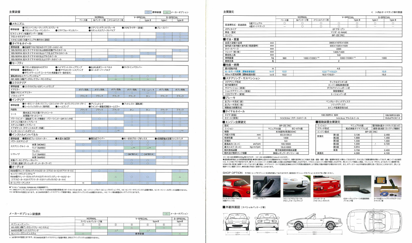

Impossible to tell though if its an S-Spec 1 or 2 (the only difference being 15" BBS wheels).
Looking at this I’m guessing they’re not BBS wheels… Shame but ah well! Any idea what they are, think they are oem for standard eunos?
In 1996, Mazda dropped the 14" BBS wheel. So the S-Special 1 had the Bilstein suspension pack, but 14" “standard” Enkei wheels, whereas the S-Special 2 had the 15" BBS wheels.
