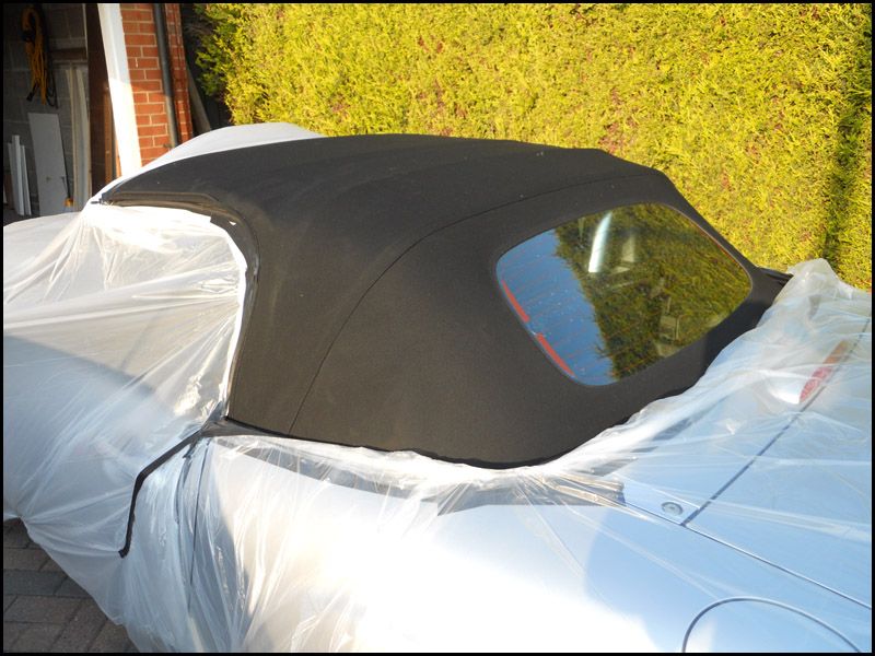

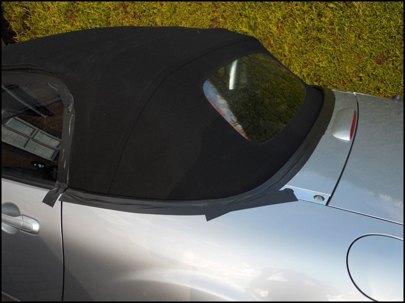

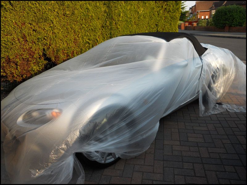

So i did mine this evening… though i think i went OTT with the masking off…
So thats the car protected Embarassed

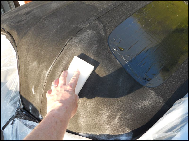

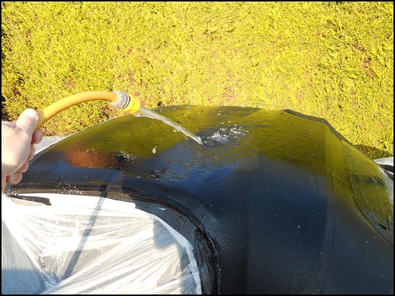

First off i vacuumed the hood, then after spraying the hood with a small garden water sprayer i applied the Autoglym soap and rubbed it in, allowing it to foam as i went…
Rinsed that off with the hose pipe…

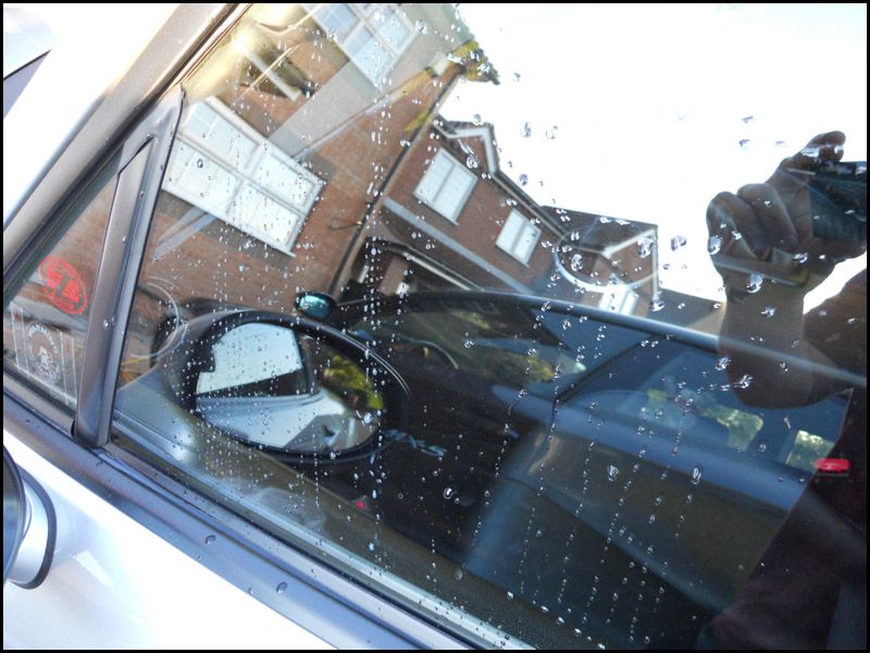

As per the Autoglym instructions i blotted the excess water off to leave the hood damp…

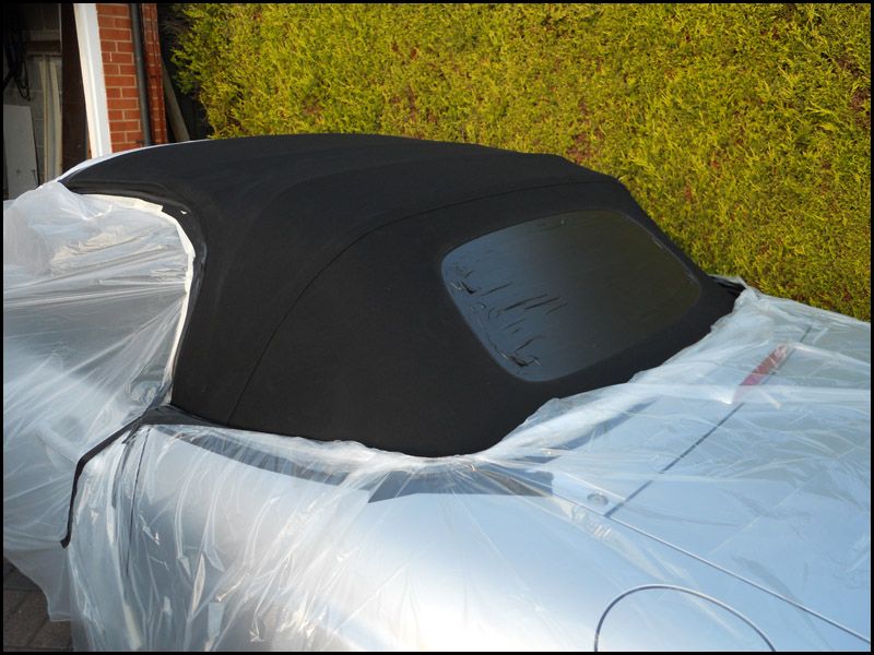

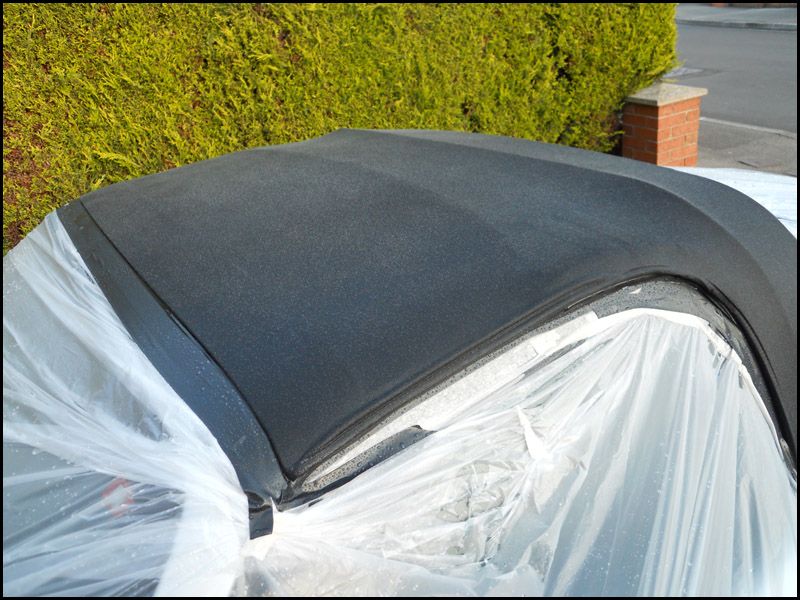

Then liberally applied the sealer / protector…
All well and good, that is until i removed the polythene…
grrrrrr…

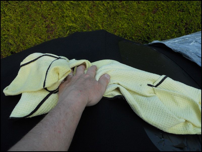

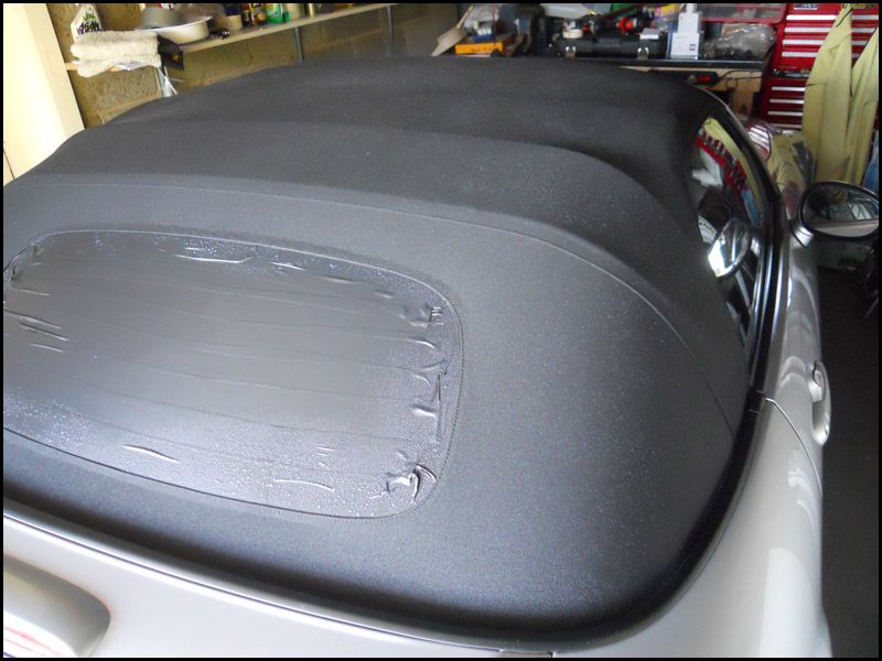

Dried it with the towel i had used earlier, hopefully it wont be all messy in the morning! I then put the car in the garage to soak overnight…
Autogym say that to get even better protection cover the hood with polythene to keep it wet over night, so reading between the lines you dont want to be treating the hood on a warm or sunny day as the protector will dry too quickly.
