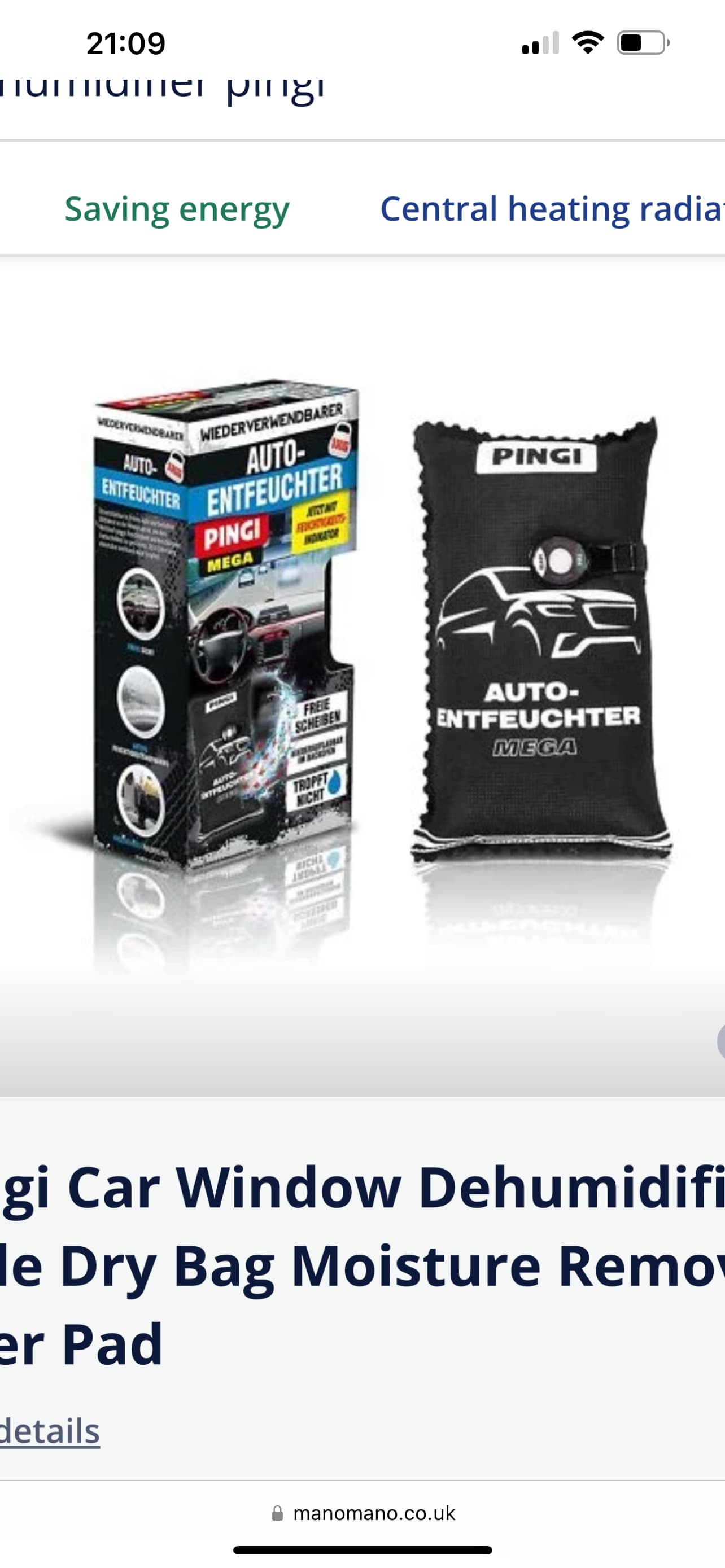

Hi got these as I had condensation inside the car and they seem to be doing the trick
