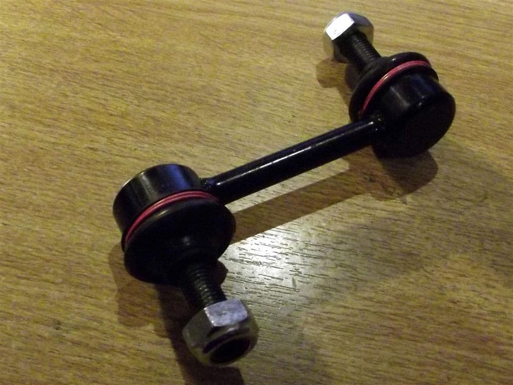

Drop links from Autolink, as I’ve just ordered some myself. Mine were in with other items, but you’re looking at £50-55 inc VAT, delivered.
Rears:
Front nearside: Stabiliser drop link Mazda MX-5 mk3 2005-15 front l/h left hand F15134170
Front offside: Stabiliser drop link Mazda MX-5 mk3 2005-15 front r/h right hand F15134150
I think mx5parts just edge it on price with these, aftermarket parts.
These are decent, bought them in the past.
Interesting Autolink say fronts fit all models NC yet mx5parts have a different part for ‘early’ NC’s, interesting?
I prefer to use Andrew at Autolink, but I recall MX5 Parts didn’t have stock of the rear aftermarket option anyway.
Not sure about the option for very early Mk3 though. It seems to only be the first year of production.

Links arrived today, so I thought I’d make a start.
Took me half the afternoon to get one bolt off and that was by sawing through it
Its really difficult to get at with the car on the ground.
You can get one hand in there ok but not the three you need.
The problem is that you can’t just heave on the nut to undo it as the ‘bolt’ has the ball at the other end and just rotates . There is a recess to take an allen key in the end of the bolt but its very shallow and rounds out before you can get the nut all the way off the thread.
I note the allen recess in the autolink version is much deeper.
Normally, I would drive a star bit into the rounded out allen recess to regain some grip but there’s no room to do that.
It would be so much easier to do on a lift…
I think maybe I need some better penetrating fluid for a start and to find a way to grip the ball so I can get the nut off. Vice grip pliers perhaps?
