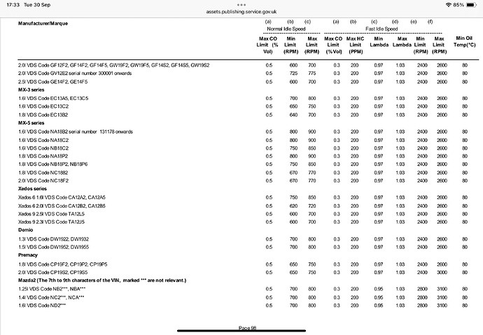

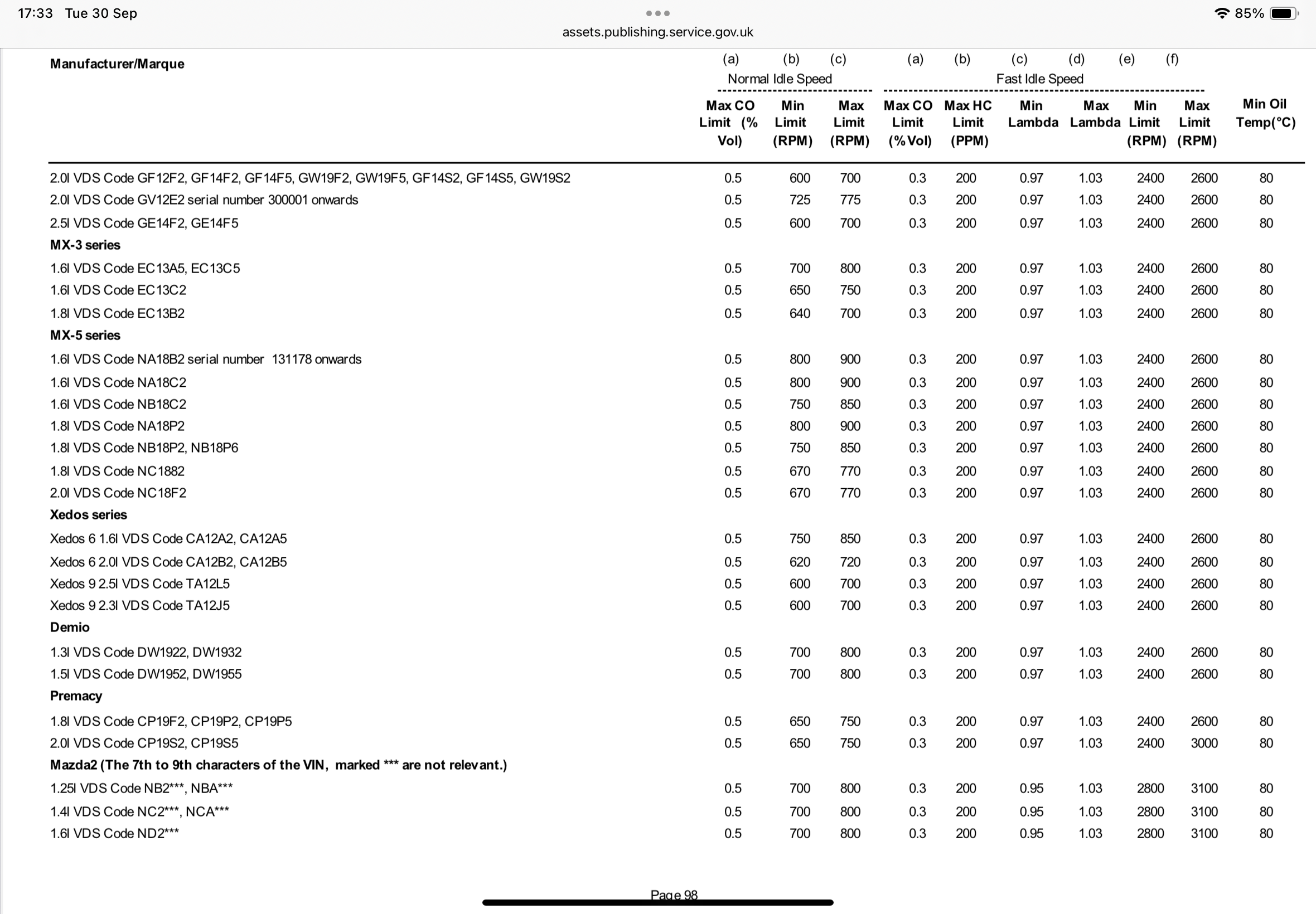

My question is, what are the actual limits for normal and fast idle for the 1.8 NB.
Vin code is NB18P2. If I look that up on the .gov website it has limits for CO of
0.5% on ide
0.3% on fast idle
See Vehicle exhaust emission standards - GOV.UK
In Service Exhaust Emission Standards for Road Vehicles Nineteenth Edition
The MOT states limits of 0.3 and 0.2% respectively.
Have I misunderstood or misread the .gov specs?

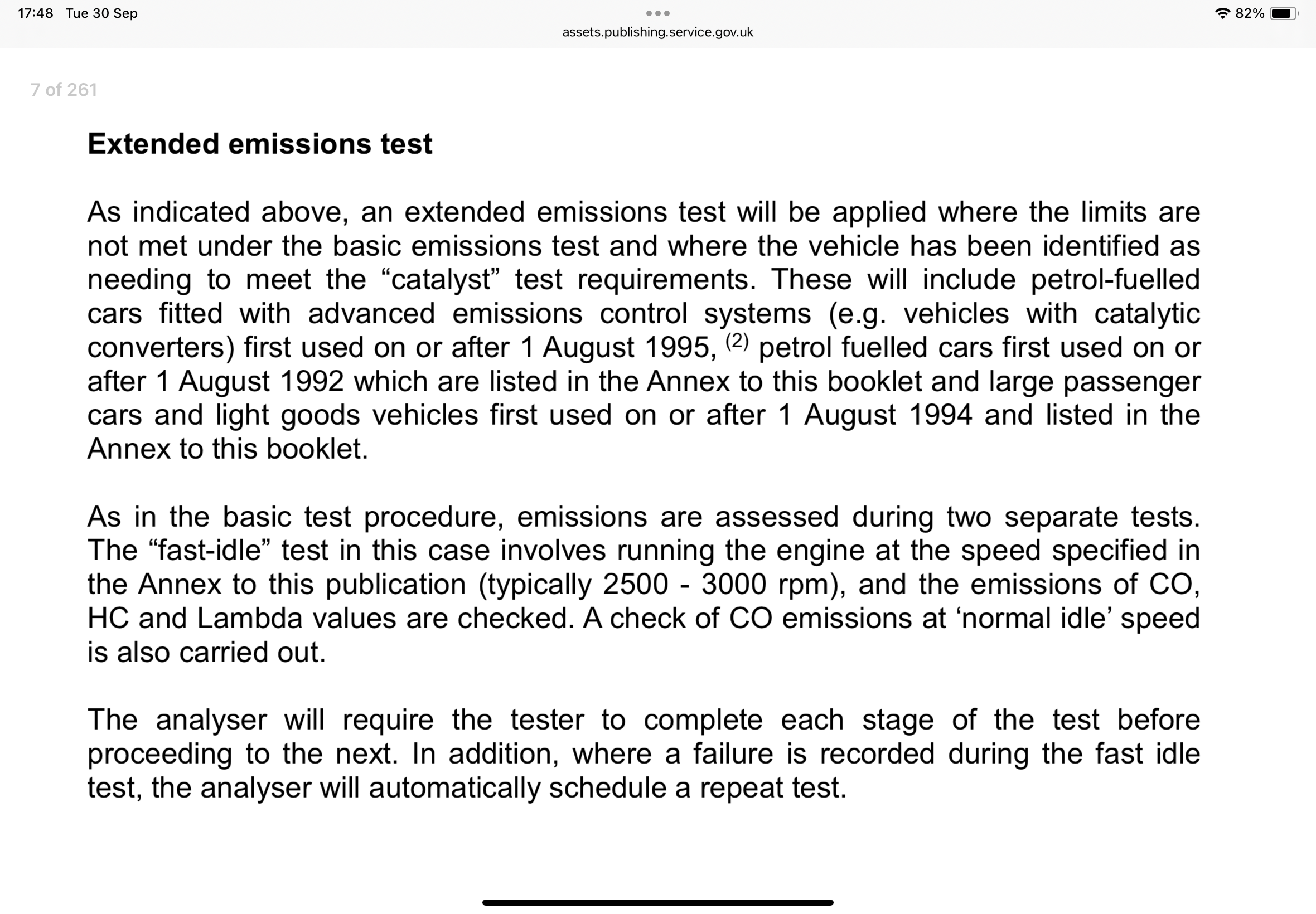

Mot tester has got it wrong. If it fails the basic emissions test, the tester must proceed to the extended emissions test referring to the annex.
If it still fails, try setting the spark timing to 14 degrees advance. It’ll give the fuel/air mix a little more time to fully combust.
