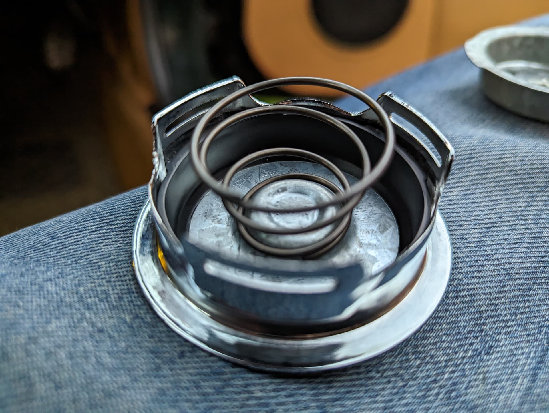

Anyway, I went back and pulled the horn contacts off again and contact cleaned them again and otherwise fiddled hopelessly and arrived back at the horn working again but not turning off when I tried to re-seat the button. Carefully disassembled/reassembled the button repeatedly and it now works correctly with one horn.
Benefits of having two! I’m not sure what I did this time as it was just repeating steps, but that should be enough for the MOT retest tomorrow so I’ll avoid touching anything further and leave the other horn as a problem for future me.
Mystery partly solved, the horn disassembly was so simple that it was the only part I didn’t photograph for reference. So I re-assembled it incorrectly the day after. :roll_eyes: In case anybody else ever needs to see pictures…

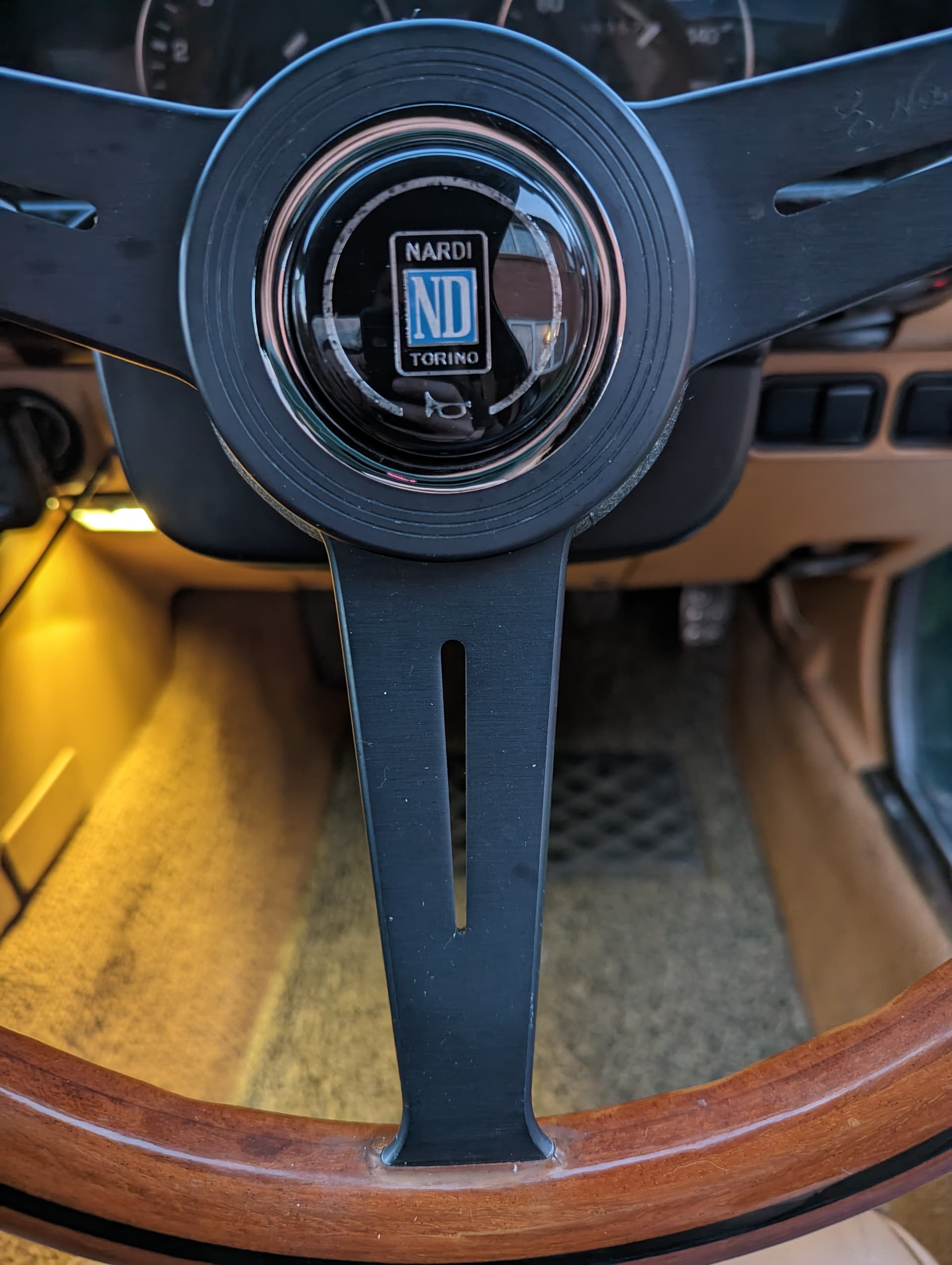

This is the wheel/horn I’m referring to:
When the button is re-assembled make sure the spring is this way around as shown in the photo, with the large opening away from the button.
Intuitively it seems like it should be the other way around as the small end coincidentally clips into place exactly around the circular brass plate (not shown)… which completes the connection at all times and means the horn won’t stop sounding. Obviously, in retrospect.
This is the tilt on the horn button I’m referring to, conflicting information about whether it should be like that but it didn’t affect the horn working correctly.
