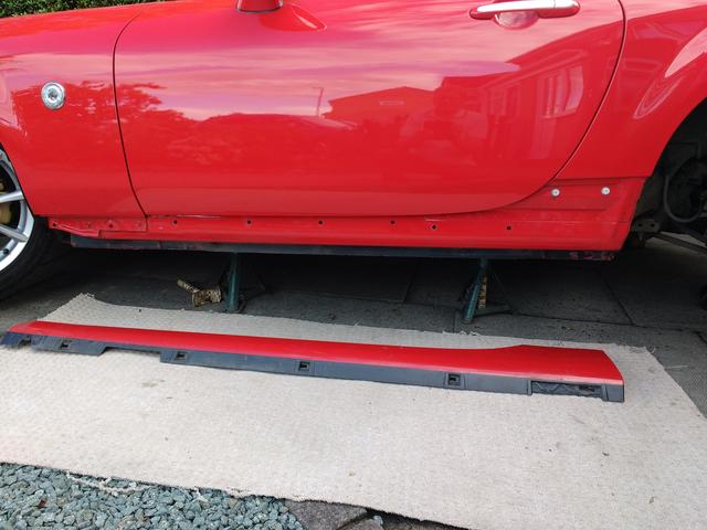

In the picture below you will see my sill cover removed, note the two white plastic clips left in at the top of the skirt where the cover meets the quarter panel. These clips are the ones in the first link below, 10 per side (so 1 pack per side) should do it. These will definately break as you remove the sill cover, tbh they are the same clips as the clips holding door cards on the Mk3 as I measured them with some spares I had. You can also see where the holes are for the rest of these clips along the sill.
The lower part of the sills are held on with the larger clip, the second link down. With these I never had any break so reused the ones on the car. These clips fit into a larger hole along the lower part of the sill and the sill actually slides along and engages with these. Lower clips needed 5 each side, if you look along the lower part of the sill you can see the fixing points
To remove the sill you need to detach the rear fixing plug/screw (black) on the lower part of the sill/arch then starting at the top part rear of the sill (the two I show in the picture) prise the sill away from the clips then work along and gently remove the rest. When you get to the last clip it’s a bit fiddly to get the front most clip out, mine was a little stubborn. A trim removal tool is ideal or as I used stiff putty knife type tool wrapped in tape for protection. Once you’ve removed the upper clips and pulled the top part of the sill away all the way down it’s length (maybe two pair of hands better) you can then ease the sill rearwards and it should slide off the lower clips. I had to give mine a gentle tap on the front end or spray some silicone on the lower clips should ease it off better.
Remove all clips replace broken ones and it’s just a reverse of the procedure to refit, a bit tricky though sliding the sill back on the lower clips, two pair of hands maybe be better although I found a little swearing helped when doing it solo.![]()
