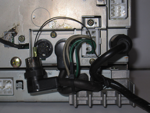

Like the factory cd-cassette, the two units are connected by an old fashioned DIN lead; this might be loose, disconnected, or just needs reseating. I suspect if the amp isn’t connected properly, nothing will work.
To remove the radio for examination, the critical element is to remove the central eyeballs, to get to 2 screws (the rest is pretty, I hope, self evident). The radio surround can be removed, leaving the radio, which is screwed into a chassis, in place.
