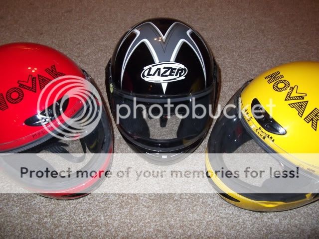

Hi All,
So you’re thinking of attending a track day, hill-climb, sprint-meet or anything else that requires a helmet but you don’t want to buy one.
Then fret no longer!
All Club members have the use of the Club helmets. All helmets are supplied with a cotton balaclava for hygiene purposes. Please wash before returning!
New Club Helmets being puchased, please see Blyton Helmet buy thread
Just email or PM me the measurement around your head (just above the eyebrows around the widest part of the crown) and provide your membership number and an address and I’ll post you a helmet. Postage approx £10, then, once your finished with it, simply post back Big Smile
Or, if you happen to be around Yorkshire, you’re more than welcome to come and collect one Thumbs up
All helmets have the BSA blue standard so are suitable for general motorsport use, including trackdays and many hillclimb and sprint events. They are not suitable for Racing.
The Club helmets have been checked for obvious signs of wear and cracks etc but are lent in good faith and used at your own risk.
Cheers, and happy track-day!
Jon (peleton72)
