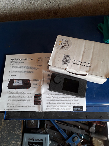

This little gadget is available , goes into the under bonnet port. I got this last year when it was advertised in the STHT magazine, about 50 pounds but has got some nice test features aswell as reading codes.
Thanks! much appreciated . I’ll look into this. Cheers.
