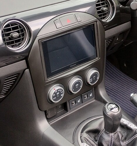

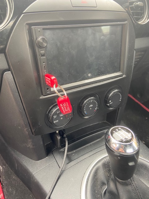

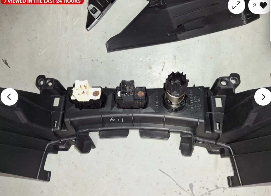

Hi Chris thanks for the reply much appreciated the part you removed from the centre console did it have the cigar lighter in it (see pics) and the replacement part look like the picture attached
as the parts available are currently on E-BAY
Chris forgot to ask did your replacement have a cigar lighter plug in it as I use mine as you can see with a USB adaptor Thax

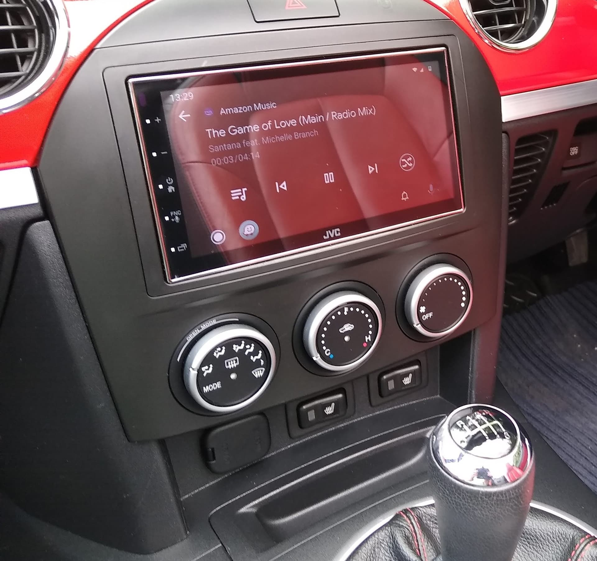

Make sure you buy a set of switches (the panel below the heater controls) that are from an NC1 model. These have the rocker type switch on/off fitted. The variable switch type panel from an NC2 isn’t going to work with NC1 heated seats as the wiring differs for the variable control part of the switches.
If you have the heated switch panel either for NC1 or NC2 then both come with the 12v socket that’ll take an USB type adapter, it’s never been a cigarette/cigar lighter socket😉
Both switch types below, NC1 top, NC2 (variable) below.
