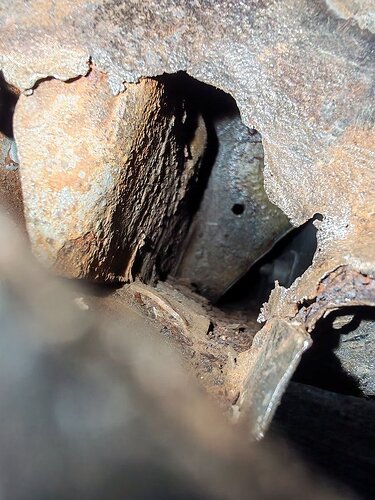

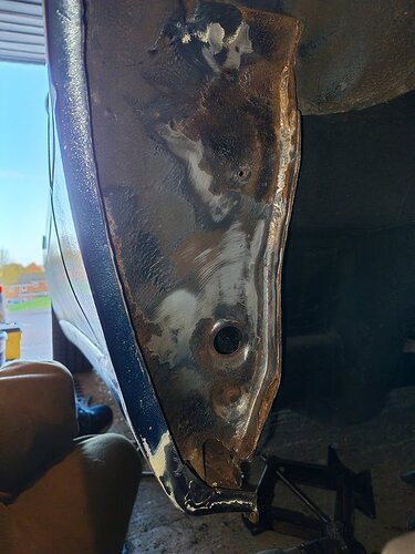

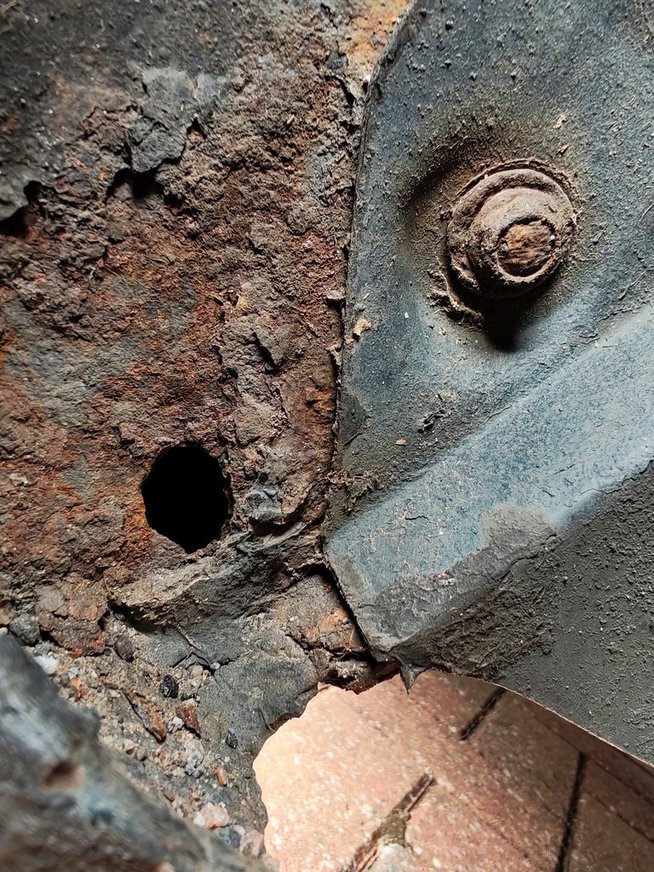

Rust. No rust advisories, but one of the end plates now has a hole in it and the other isn’t far behind. And the “inner sill” (he meant the floor pan) isn’t looking to clever. Knew the lip was a bit flakey but hadn’t investigated further.

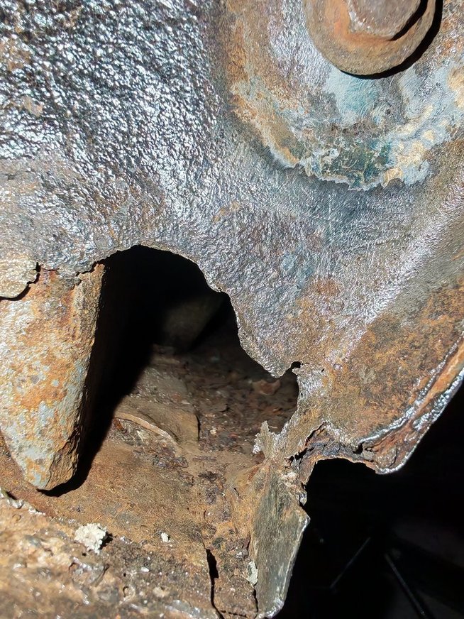

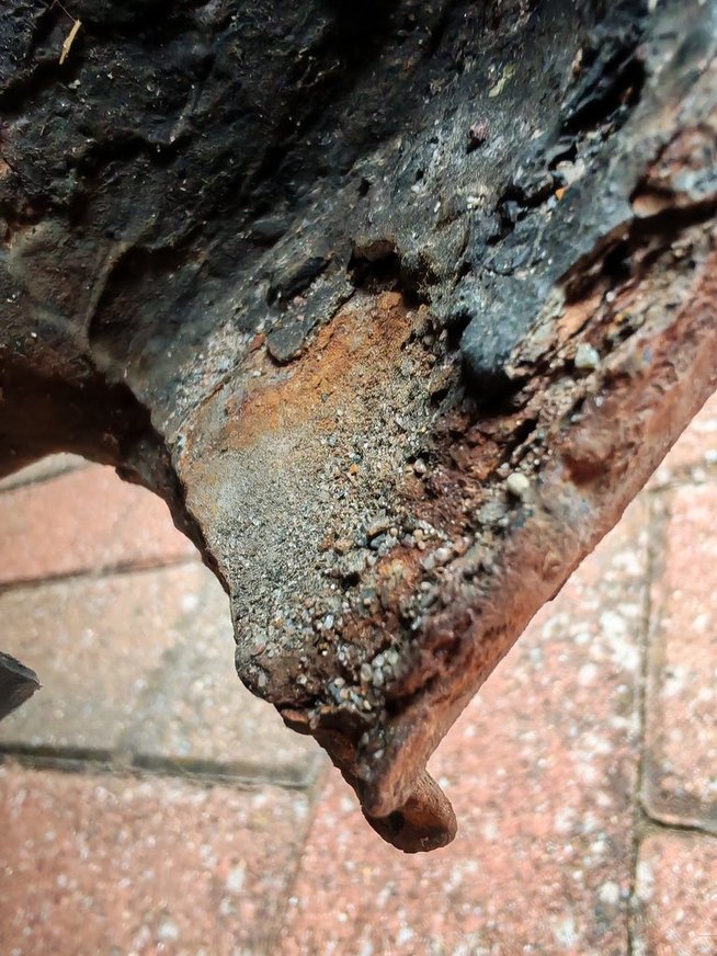

I’’ll have a proper poke around, after the car has sat in the garage drying out, take a wire wheel to it, and see how much metal remains. Hoping it’ll be just a patch up, Other side is rusty as well but no holes.

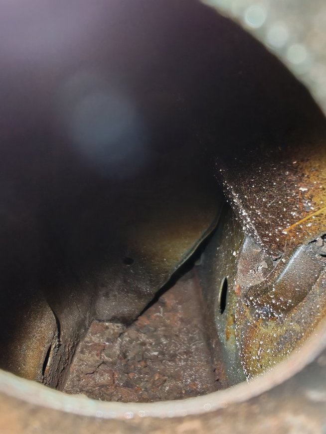

As expected the little hole got bigger, and I had a good view of the sill itselt. Above the inspection hole, the metal isn’t rusty inside. Below, its crusty. The sill itself is solid, and the new metal from 2017, once sealand and filler was taken off, was still shiny.
