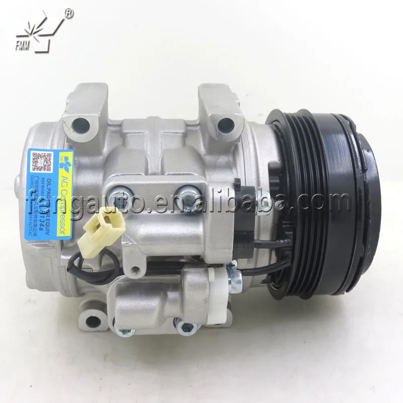

My compressor is leaking dye from all around the center section. From my research so far, best option is a new one from Mazda(no idea on cost). Also, best get the later compressor from a 94/5 model which basically have newer bearing so will freewheel lighter; less strain on engine. There used to be seal kit to rebuild but cannot find one. The Aliexpress one is another interesting option. But, would be best to see actual customer’s opinions before purchase. Anyone on here used one?
Anyone used one of these?
