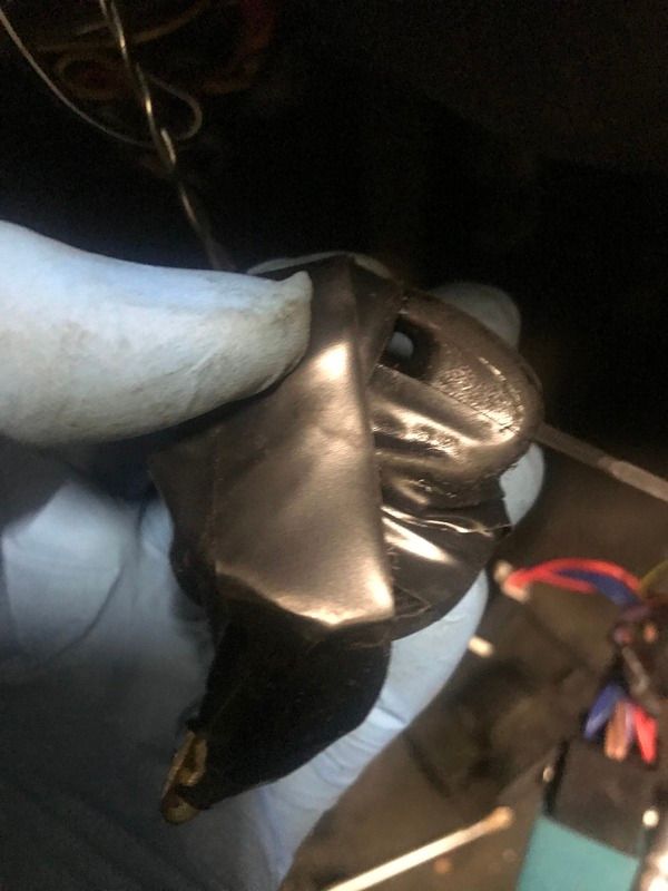

My little NB has been developed over the past few months into the potential track car it is going to be, problem being that upon stripping back some dodgy wiring under the dash I found this:

  1. Can i bypass this transponder as it’s plugged into the loom with a key DUCKTAPED to it 2. Can i remove the whole “key” assembly all-together and use a switch? This is a track car thats located in a locked garage thats behind a locked gate with a BIG dog.

Hi Dan
The key is taped there so that whenever the ignition is turned on it picks up the chip information from within that key to enable the immobiliser to pass control to the ecu.
You need to leave it in place as car will not start without chip information.
There are neater ways of doing this and keys are very easy to clone on this car. Private message me if you would like to discuss.

The immobiliser I speak of is the factory one on this car. Under the dash to the right of the steering column you will see a cigarette packet sized box marked NC30 or GE4T - this is the factory fitted immob box.
Not possible to bypass as far as I know - you have to work around this.

The basic rules are that paired immobiliser box and ecu communicate with via the transponder chip(s) coded to them. The ring around the key entry is the chip information pickup.
It should be possible to make any repair to these where necessary without changing any locks/ignition as these only rely on the physical metal key cut to code.
Not actually sure what has happened to the original posters car in the past but suspect there has been issue with the original ecu/immobiliser and the repair has been done but not in a very satisfactory way. I expect the keypad to be associated with an aftermarket alarm, totally separate to this issue although wired to ignition and possibly sounding via the horn.

considering that he wires were twisted together and not soldered I have no faith in the original owner/installer.
I think it may be an aftermarket alarm although taking it off didn’t set it off so you can see the level of electrical expertise here!
Likely a dogs breakfast of a car, had a used steering lock fitted from one car, and a used ECU from another car. ECU replaced because? Fixed up for cheap, and probably corners cut elsewhere. Its a bodge. Hopefully, it was very very cheap.
