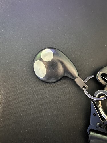

Hello, my car keys were working fine yesterday but today they have stopped working. I have tried replacing the battery on them but that did not fix them. I don’t know if I need to try reprogram them to my car or replace the fob? Any help would be much appreciated. (Also there used to be a red light that flashed when I pressed a button, but it no longer flashes)
This is what they look like if you need that.
Looks like an old Cobra key fob, there’ll be a relearn procedure to search google for.
It’s usually something like hold a button down for certain time.
Thank you I will try that now
Tried that and it is not working what should I do now?( it says that there should be a flashing led but there isnt
I fixed it, noticed something was nicked off the pcb so I soldered it back. But I still needed to pair it. Thx for the help
