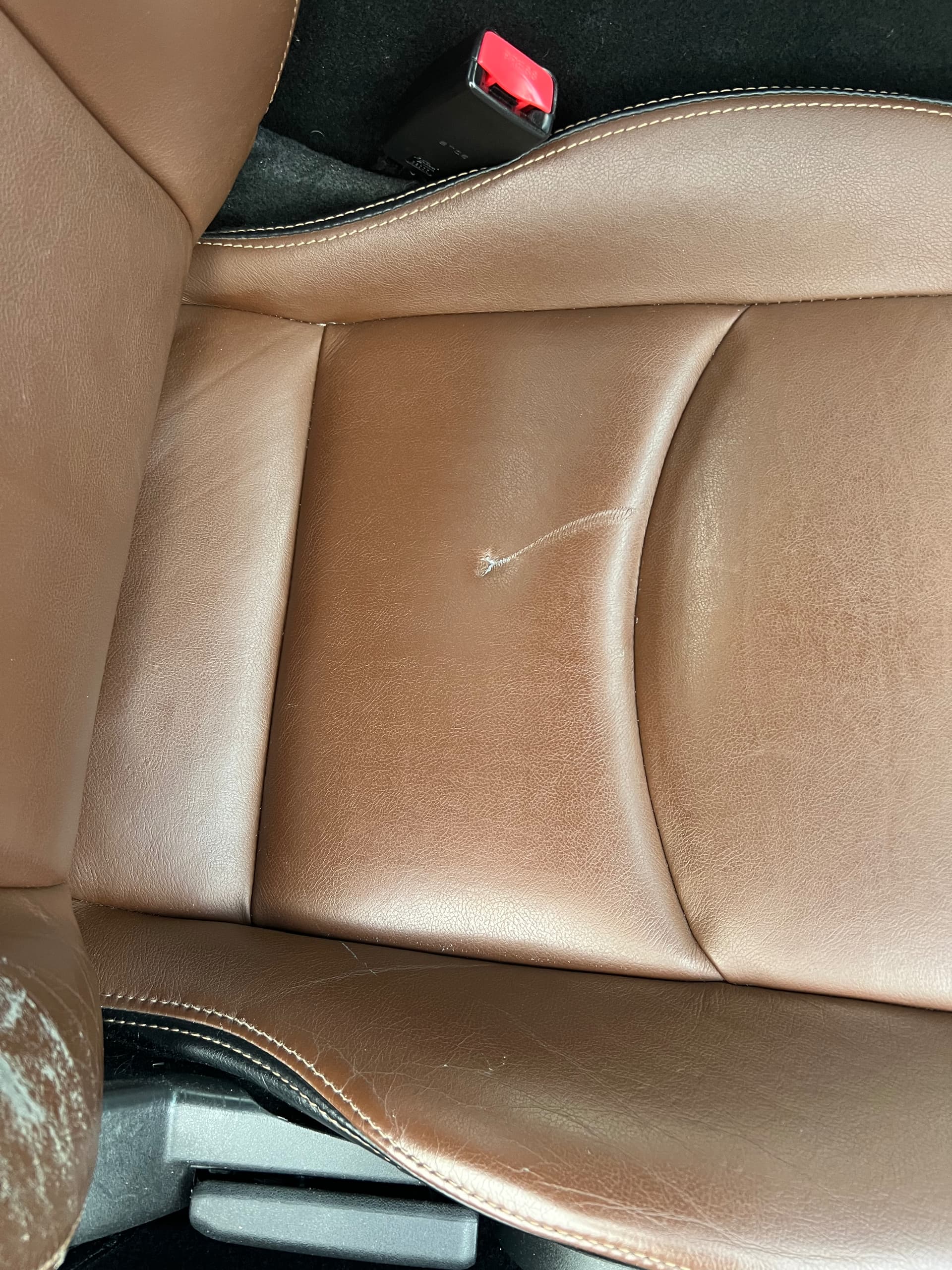

Can anyone assist. I have the above and have included a picture of the seat bolster wear. I want to re-dye and have had success in the past with other vehicles. The issue I am having is has anyone done this before and could you provide the make / code of any dye you used previously that was a good match.

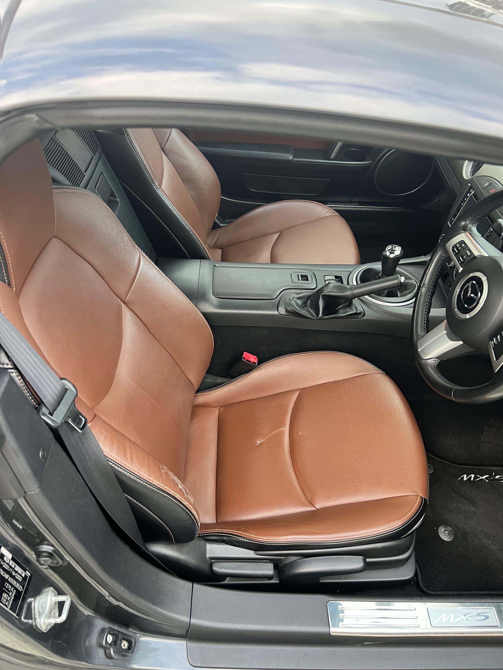

Does anyone know which shade or product would be the best for the seats in a 25th Anniversary Edition?
