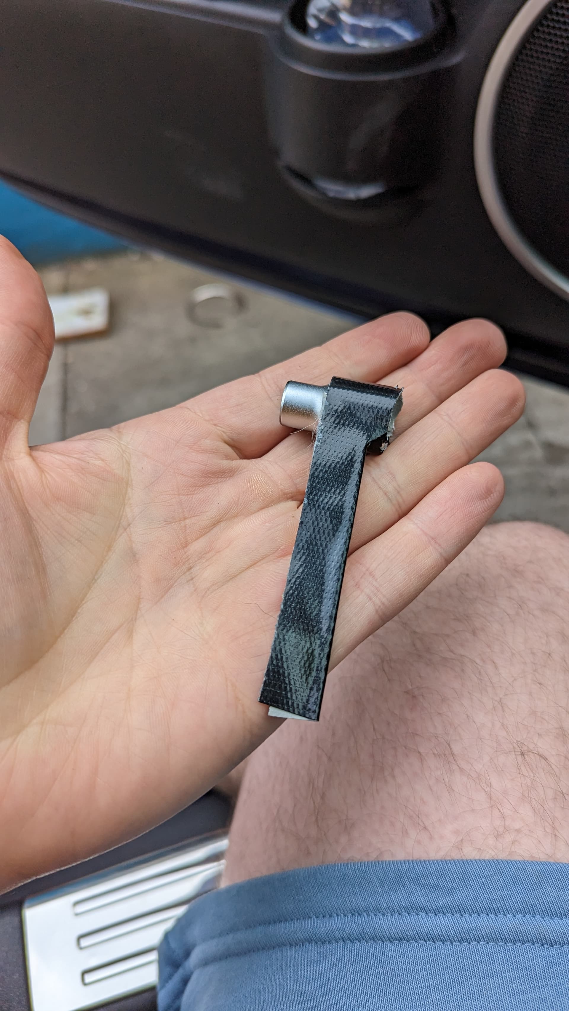

It ended up being the blower resistor/MOSFET. It was a really unpleasant multi-hour blind struggle on the floor of the passenger side to replace it.
Ended up using just the wrench bits with sticky tape on the nut end (to affix it to the nut) and a strong tape wrapped around the nut so I can pull it to break the nut and then unscrew by hand
A thicker wrench bit will also be easier to hold with you fingers.
