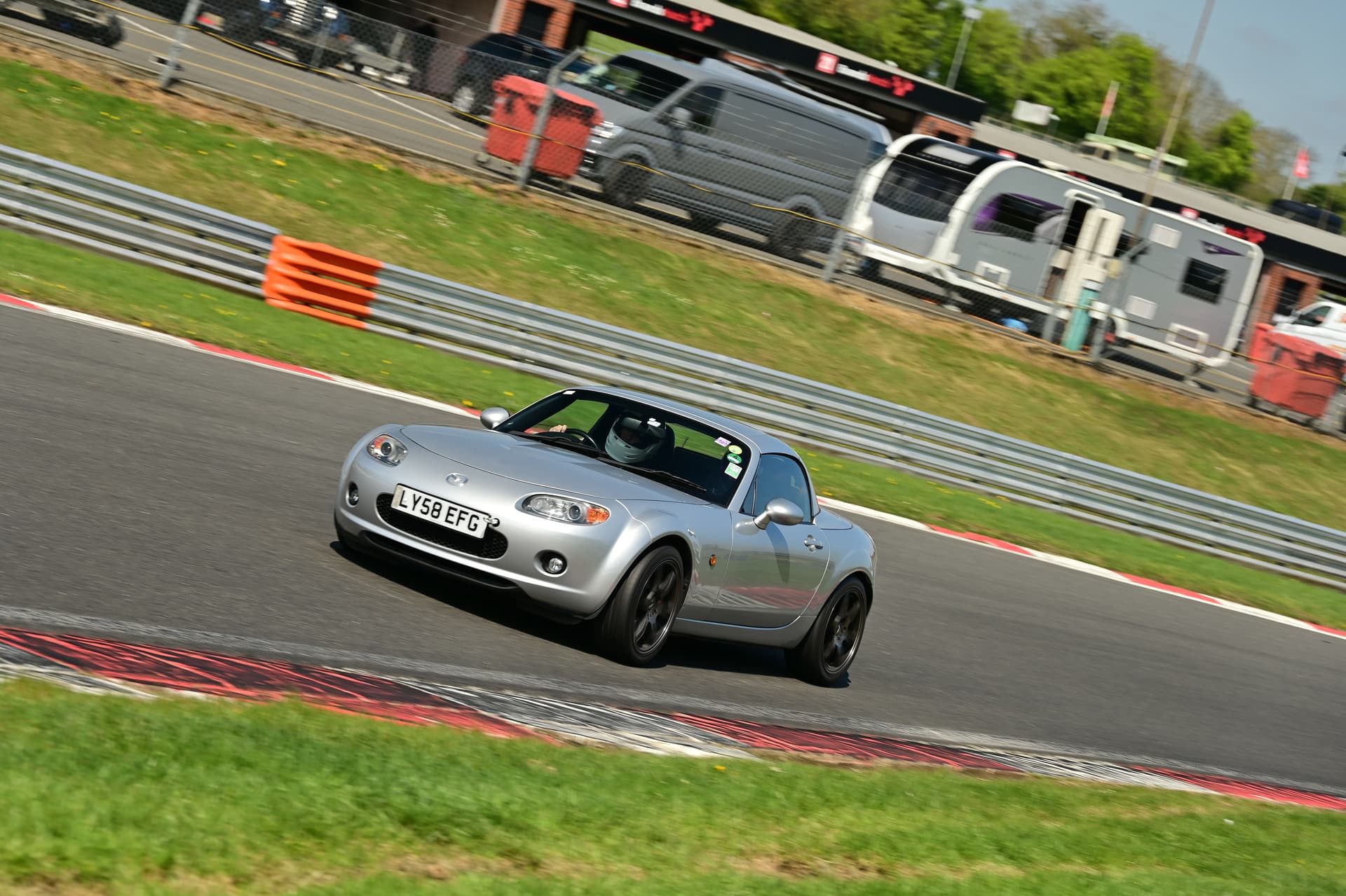

Managed to get my seat fitted in time for a very wet Bedford and my first time on track in the MX5 today.
The car was incredible with so much balance and was great fun to chuck around. As some of you will know from my intro thread I’ve owned some cool metal, none of which gave the confidence of the little Mazda, what a car…
…however one thing did let it down which was the brakes, with a real judder occuring after only 3 or so laps. Given it was wet this was quite disappointing. The previous owner fitted braided lines and Castrol SRF so no problem there which means it must be the EBC grooved and dimpled discs and red stuff pads. Both fine for the road but not great on track.
Think I’ll just get some plain discs and roddisons pads.
Overall though super happy.
Couple of proper pics, running the car soft certainly helped with grip!

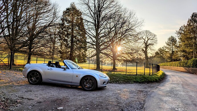

Then finally managed to get out this morning for a proper drive… What a special little car this is. 70% of a Caterham for 10-15% of the cost I think and based on my ownership experience of one.

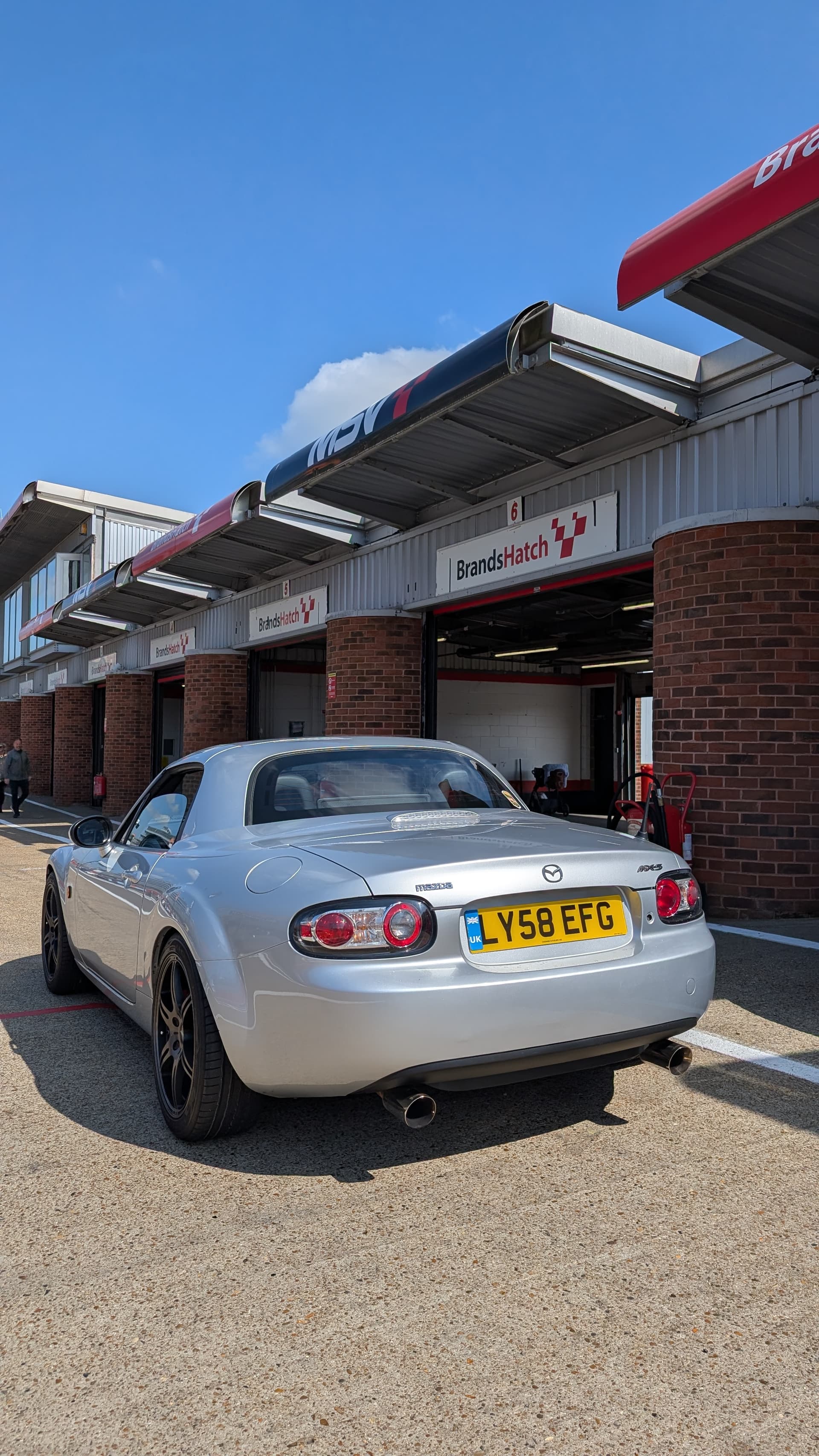

Had a brilliant time at Brands Hatch last week, whilst the car is obviously a bit underpowered it still provides a huge amount of smiles and that is a fact that was backed up by so many other MX5s and in particular NCs there.
When I bought this a year ago as a stop gap for a trip I really didn’t think it would become something I like as much as I do.
