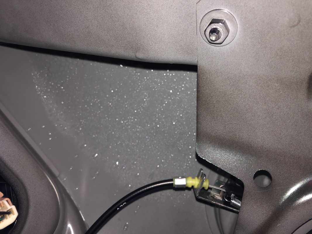

The boot carpet wasn’t particularly wet, apart from where the condensation had run off the underside of the boot from when I’d lifted it moments earlier. No obvious leaks, so I stripped out plastic panels and carpet. A quick search with torch did reveal a lot of condensation on the inside rear quarter, passenger side, and all around the fuel filler assembly… the image below shows condensation on the inside rear quarter… small spots in the photo are beads of condensation (apologies for the photos, they were the best I could get with mobile phone): -

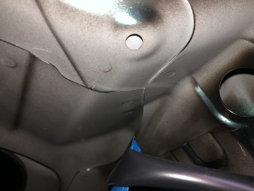

But there was no obvious place for water to find its way into the boot! Then, suddenly a drop of water landed in the boot, from right up on the underside, inside of the boot, near to hinge area… there’s a small glstening blob of water right between two small panels: -

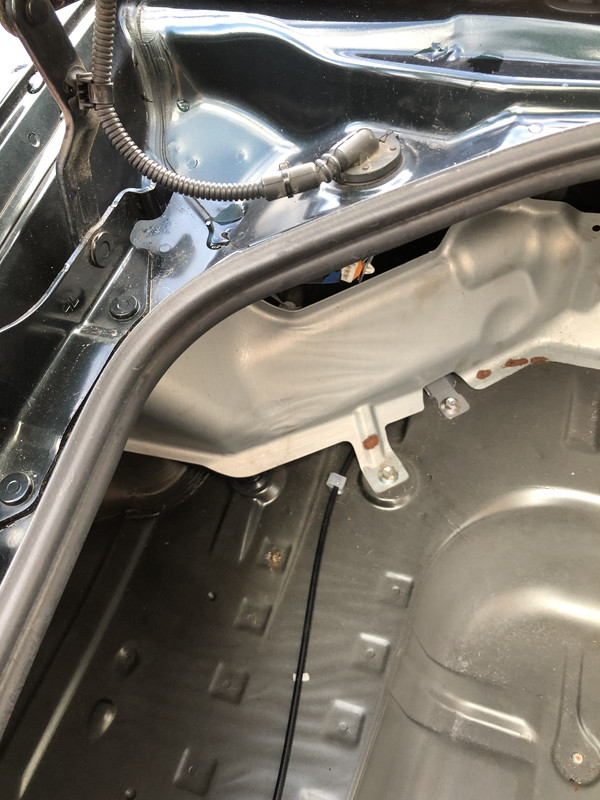

I wasn’t expecting that… a leak THROUGH panel components… and from topside, in the boot-shut was this little puddle of water, right on the panel seam behind the hinge- mechanism: -
A quick dry, and liberal application of Fernox L-SX on the topside (BOTH sides of the boot) left over from scuttle grommet fix in the summer, and hopefully the leak will be fixed. No evidence of leaks anywhere else, but I’m keeping the boot stripped out for a month to check.
