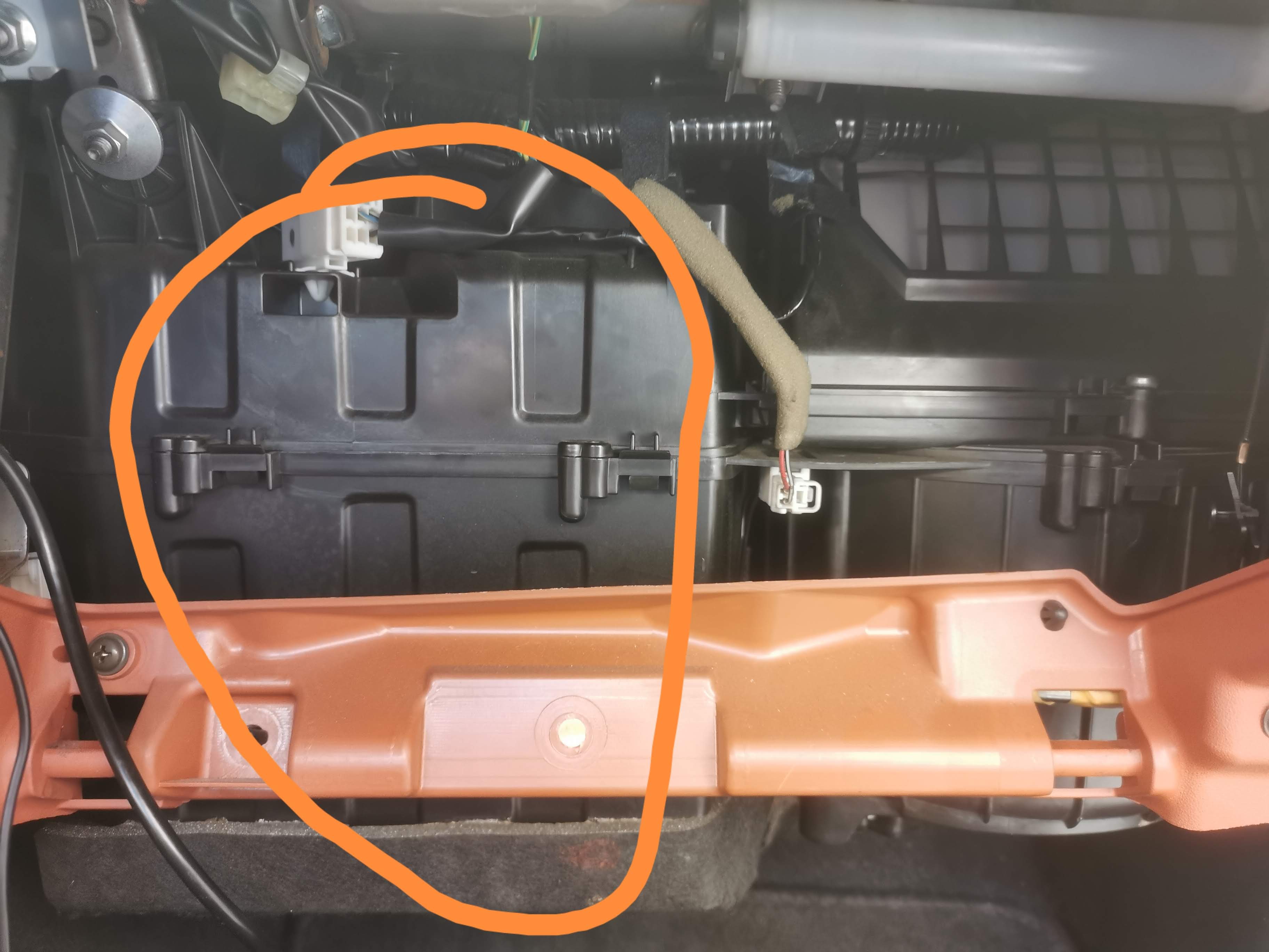

Sometimes I hear a rattle noise behind the glove box, it depends on the rev, like a vibration.
I removed the glove box and punching a bit on the black box it sounds exactly like the rattle/vibration.
What part is this? is it easy to open/removal?
It’s most likely to be connected to the aircon/heater unit. I see a couple of fastening up there try nipping the up.
There are several flaps in there (driven by a clever cam on a motor) controlling how the air moves around. That box is the air-con/heater assembly with fan in the drum on the right.
Try altering settings while it is all working and see if the rattle changes. Then it is a flap, or two, or more! Access is a pain.
Otherwise its more likely to be a bit of leaf trapped in an awkward place. That might just rot away eventually… or at least one can hope.
Removing this unit is a dashboard-out job!
What do you mean to nip them up? :thinking:
I see a disconnected white connector on the right side of the photo, like the one from the radio. Anyone knows what is this for?
Tighten the nuts up :grin:
If you haven’t got aircon it’ll probably be for that, they installed the looms with the options there anyway.
nuts seems tight, i got the aircon.
Maybe it’s something that got inside :face_with_raised_eyebrow:
I’ve found a video just now, the blower fan is easy to remove and clean (the part on the right)
i’ll try that, even if i suspect the noise is coming from the box on the left :sweat_smile:
