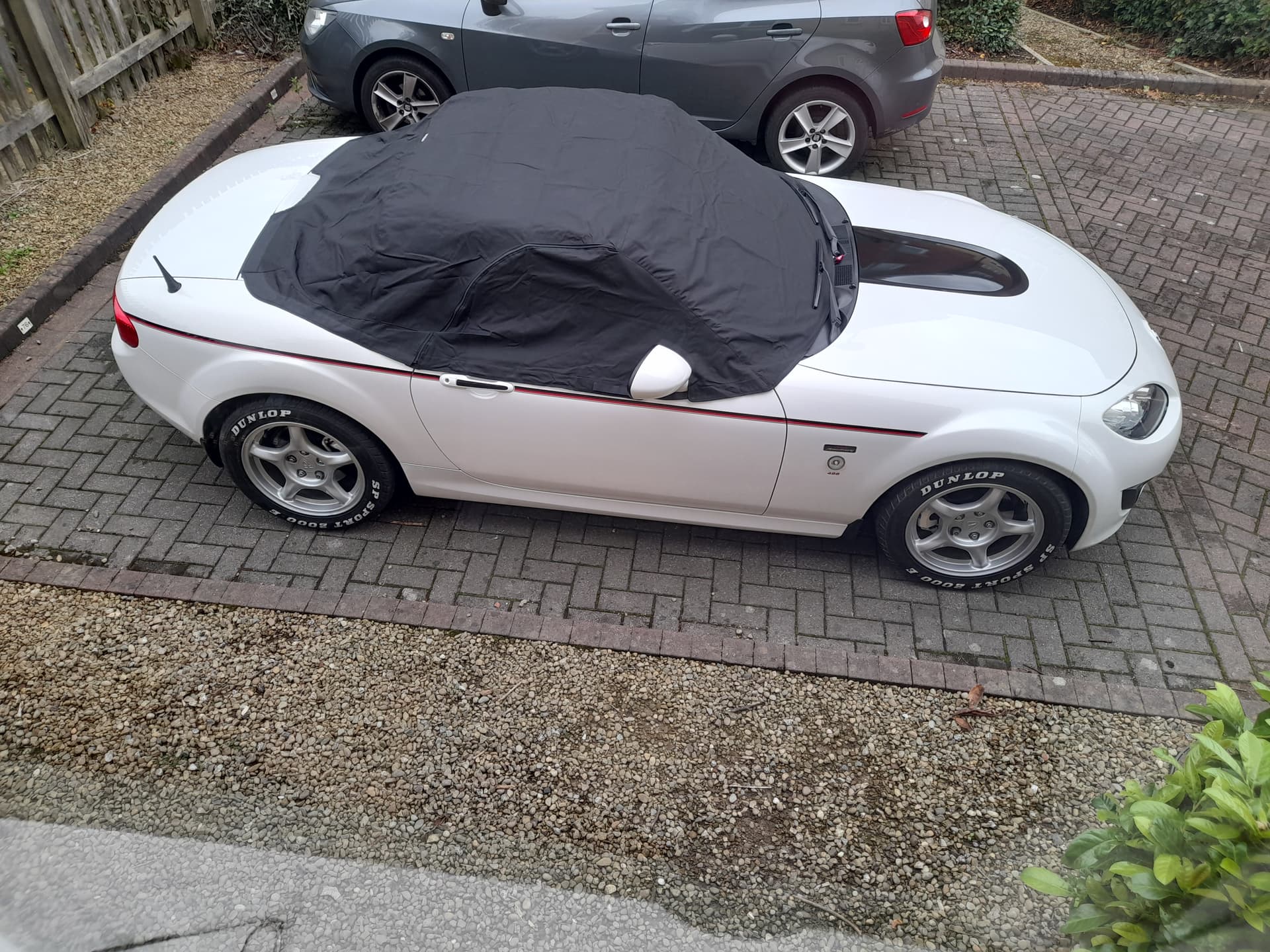

I also use a Richbrook top cover, fit is really good using magnets, straps and a thick fabric loop in the boot shut line.
Keeps the cabin dry, saves the top from birds leaving a fly past calling card and cats and their fur on top.
