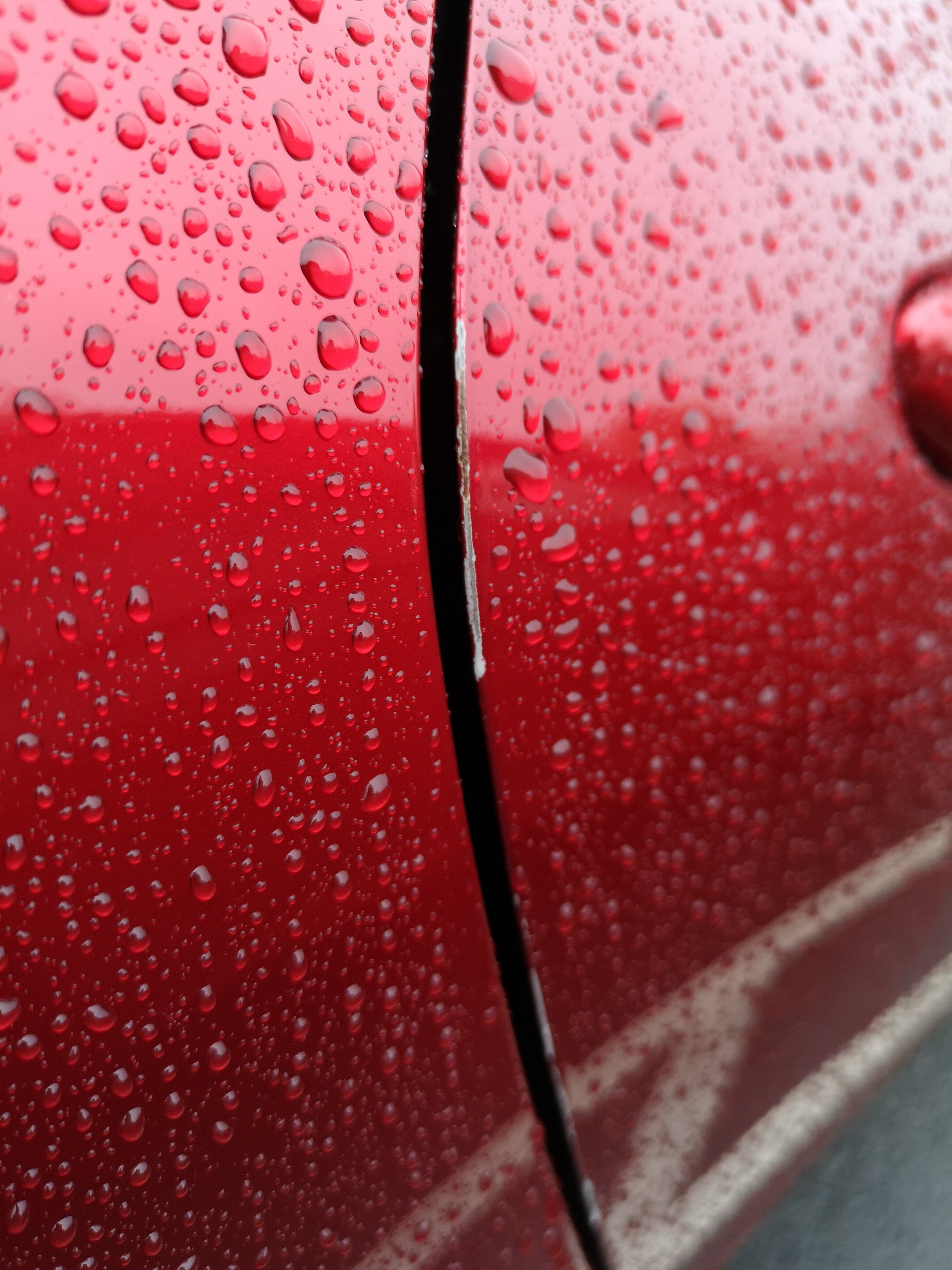

Just come to see one and there’s a fair bit of paint missing on the door edge and it’s already starting to rust! ! Big problem? Expensive?
Imo it shows a lack of care by the owner, and the dealer if it’s being sold by a trader.
Be careful

What’d that door edge cost to repair? The red is an expensive paint isn’t it

With regard to the door edge, if it’s just the edge, a DIY repair may suffice e.g. kurust, primer and soul red touch up.
If you want paint the whole door, remember soul red is 3 layer, colour, flip layer and lacquer, so a bit more expensive and you may need to blend into rear and front wing. I reckon £600, but maybe get a quote.

Paint missing on edge of door

I know someone on here did a really good job touching up a paint chip on a Soul Red MX-5… With time and care, that could be done well.
