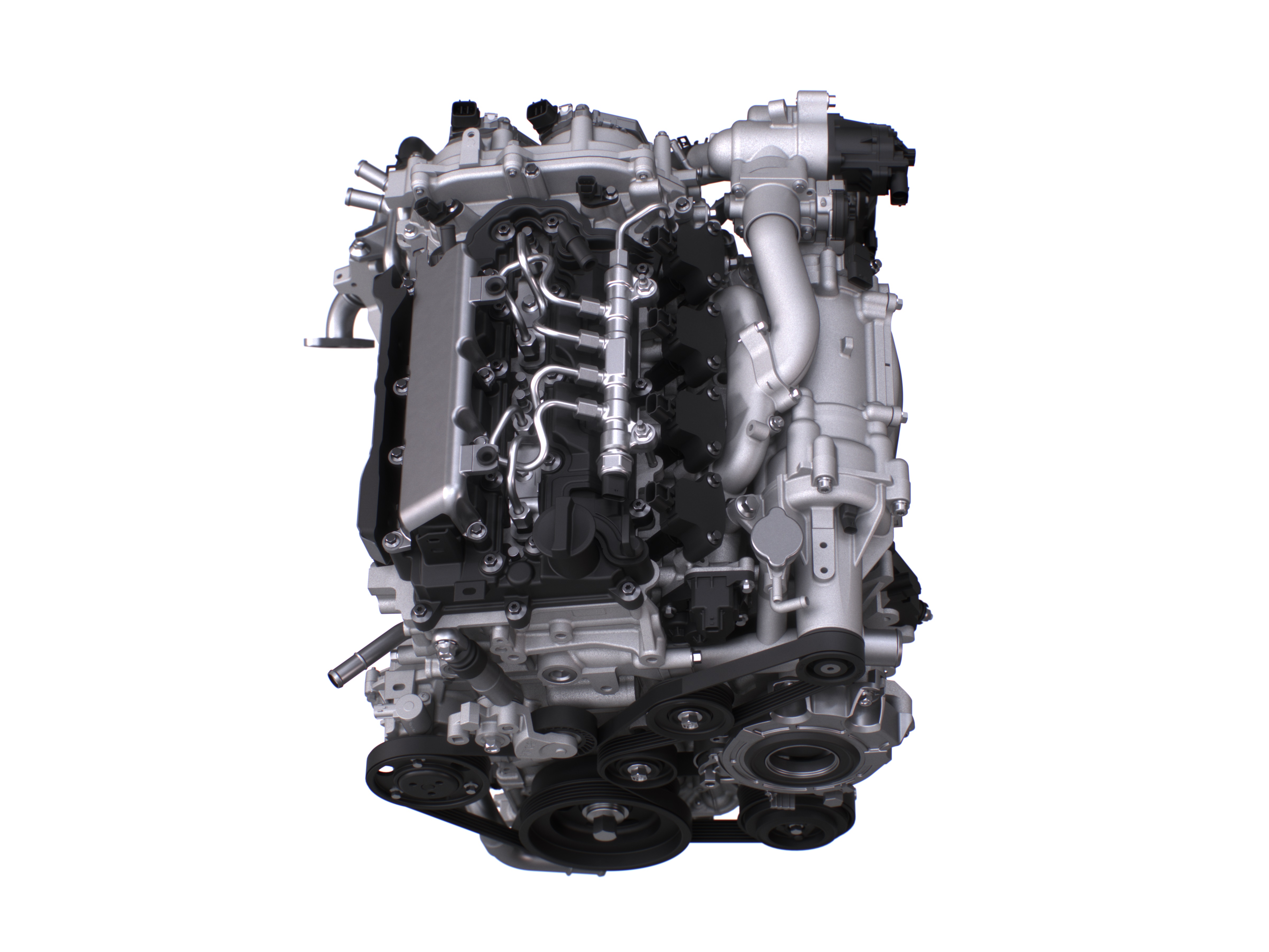

It is because on a cold start the combustion chamber, incoming air, atomised fuel, etc are too cold to support the normal (hot) running with spark-assisted compression (almost diesel-like) ignition on a lean mixture. See that clever diagram in the Mazda bit.
So in this case the mixture is richer, and the spark is essential, and the various timings are fiddled to be more like an old-fashioned petrol engine, but it still has the high compression ratio, hence sounding diesel for a few seconds.
The -X engine with the sensors inside seems to be the future if it can minimise the big change in mode that is all too obvious with the -G variant on our 2016 Mazda3 initially sounding like a diesel, as heard every cold morning for about fifteen seconds.

The MX-5 has never had the SKY-X engine, they are all SKY-G.
Oops, my mistake! I’ll remove that mention.
Thanks Robbie, I wonder where I read that “fact”.
