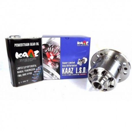

KAAZ list the same diff for NB6 or NB8
Maruha indicated the same
