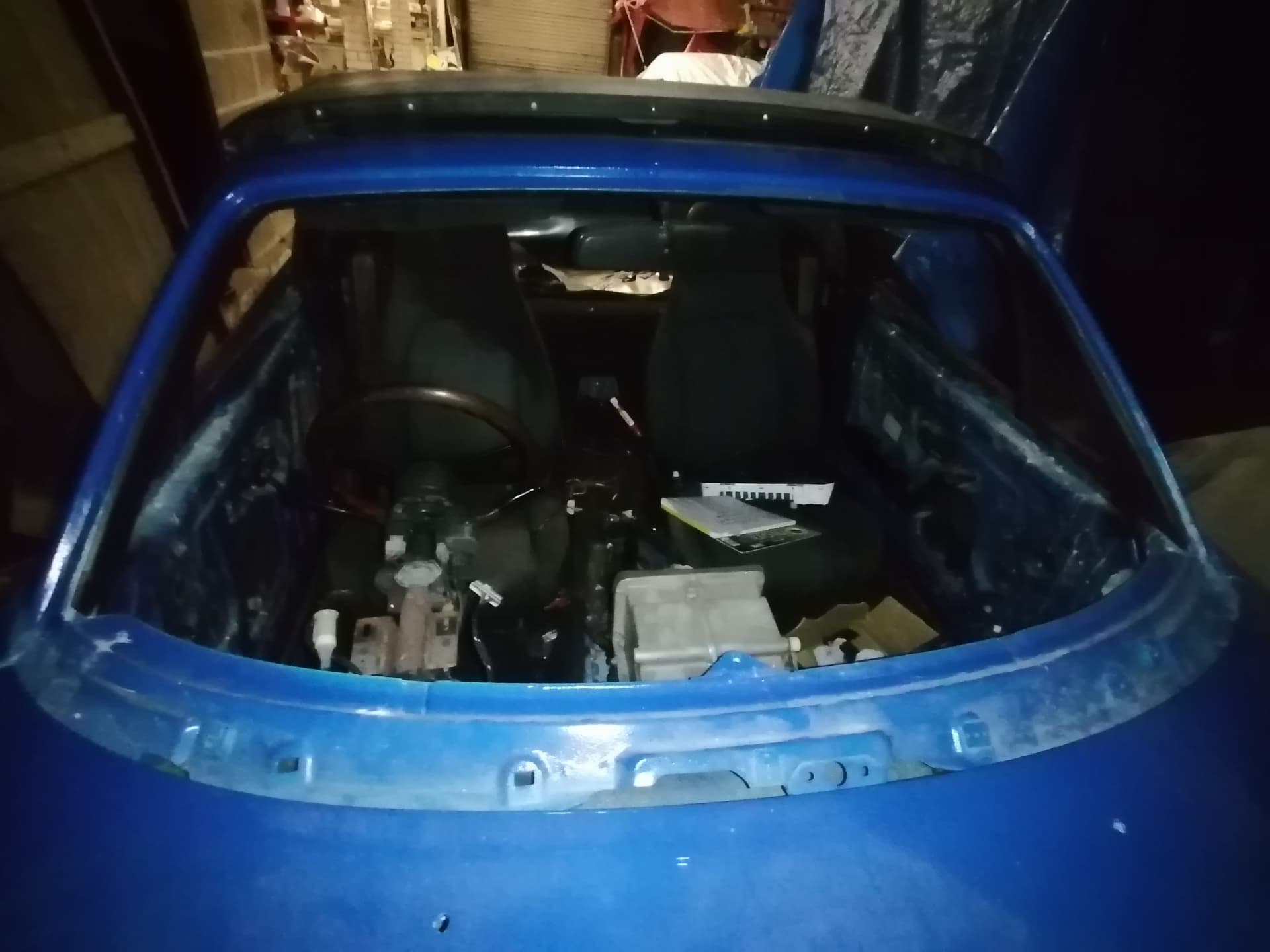

Hi, could you please please give me some advice
I have a mk1 mx5 which came to me with no windscreen in (please see pic)
Now before I get someone out to fit a new one, could you please tell me what I’ll need to complete the install .
As i understand it it goes
windscreen frame, weather strip, glass then windscreen seal/molding
Is there any plastic that the screen fits/sits on?
Does anything go between the bottom of the screen and the frame of the car ?
Also I’ve spoke to auto glass and they ask what colour tint is mine. Now came anyone tell what colour
tint it should be for a G reg
PS dose anyone have any recommendations for someone who came fit it in the Warrington area
Thanks in advance
Had to renew mine when it was being totally refinished this past summer painter wanted it out and it was in there nearly 30 years so one corner cracked when they started… he spoke to me and had a guy who did screens for a living locally and could source one, he arrived and refitted it with all the bonded in kit that they need to do so.However you’ll need to sit down when you come to the Mazda dealer for the satin black wide plastic trim and 2 buttons that finish it at the bottom, looks as if you need the receiving plastic grommets as well ,4 or is it 6 of them… well over a ton for that, count on at least 250/300 quid for the glass refit…w
