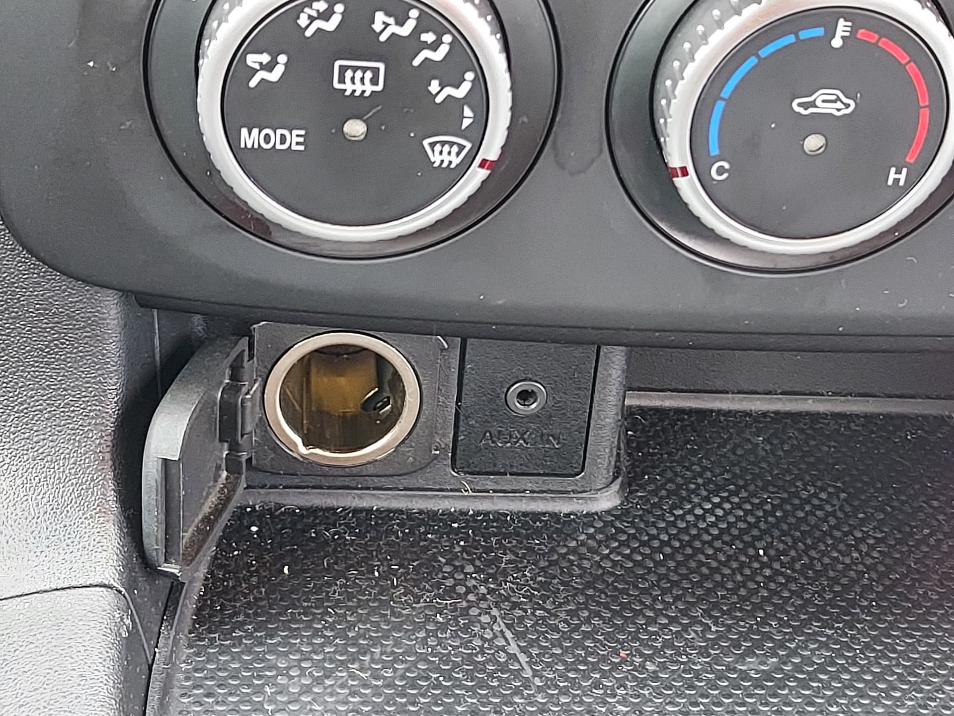

Does the 2010 come with n audio input or Bluetooth.

Yes it does
