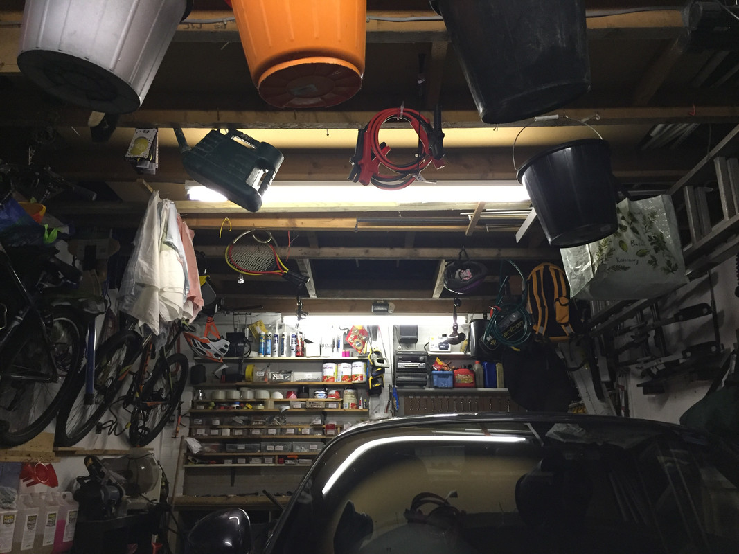

Tubes appear to be mounted too high. The ceiling joists creat a light barrier.
Richard.
tubes are mounted to the underside of the joists ( maybe pictures deceiving )

Usual crap with a garage and most of what I say you cannot do much with for many reasons.
  1. You need another shed to store all the usual crap in to allow you to work on your car, you are bumping into stuff to walk round the car.
  2. It is a biggish single garage but as always width is an issue even with all that stuff in another shed which it is not.
  3. The lights need to be below the roof trusses.
  4. You need to get all that roofwork painted white to reflect the light down and a thin false ceiling painted white will help.
  5. Assuming you have cleared the crap out to another shed, painted the cieling etc., and maybe do the floor white or gray you have three times the basic light needed for a parking garage.
  6. Depending on what you are doing you need around 2.5 to 3 times the light you have to make it good to work in as a workshop.
  7. Due to the width of the garage you may need say two tubes at each side edge of the garage. One right behind the door and another one above the bench if you can move stuff.
  8. I would be tempted to get some small strip lights or bulkhead lights down near the wheels.
  9. Fluorecent lights or similar with LEDs have a similar light output per mtr, unless you are in there every day through the winter you will not cover the cost of LED’s over fluorecent.##
  10. Have fun but it will be difficult to get it the way you want.
