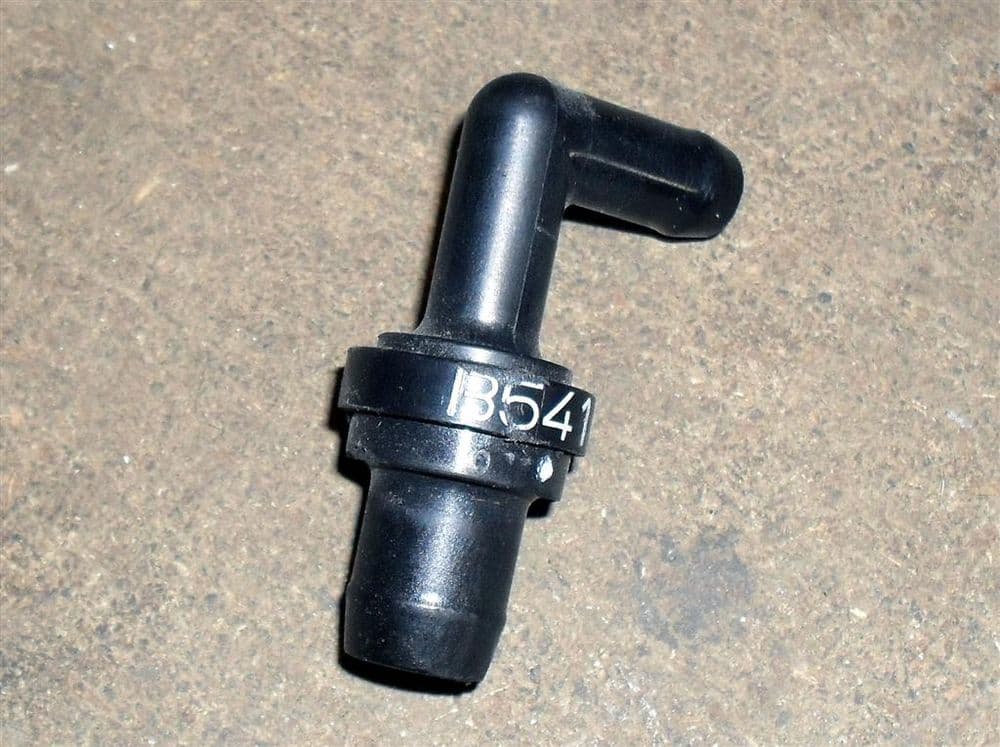

An example:
It just unclips from the offside camcover.
