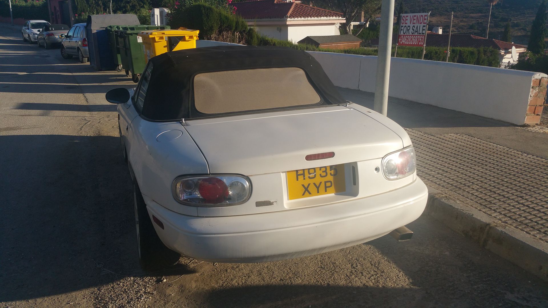

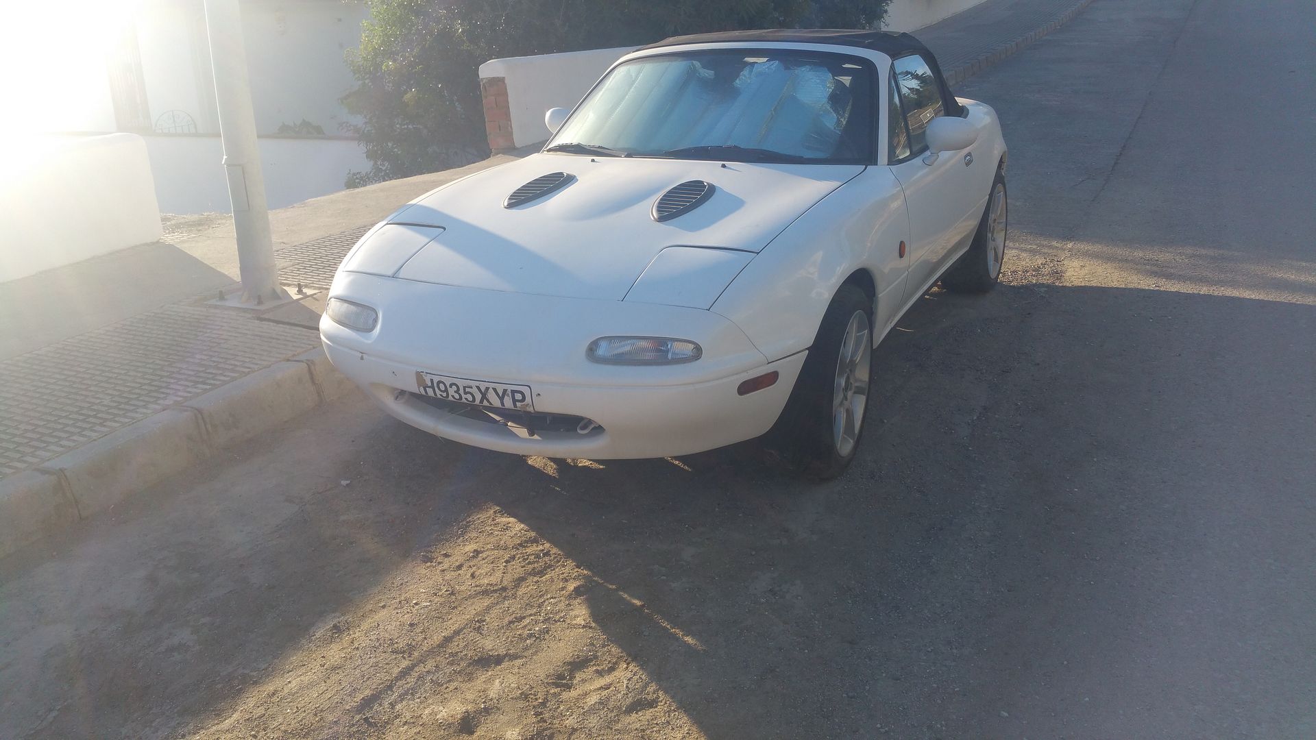

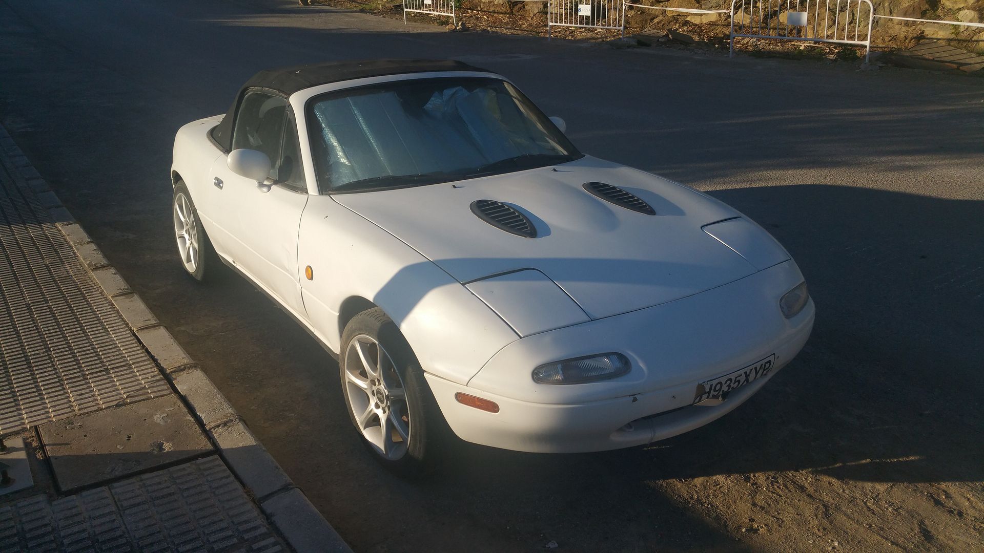

HI guys well here I am, swayed away from the Imprezas that I once owned, other cars being Volvos, BMWs, Opels and the ongoing list and bought myself my 1st MX5
So here it is
cost me €500 (cheap for Spain), its LHD on English plates which means I can mod it and not get stung by EU manufacturers law (Bullsh1t law)
1991 MX5 (Miata) NA 1.6 115cv

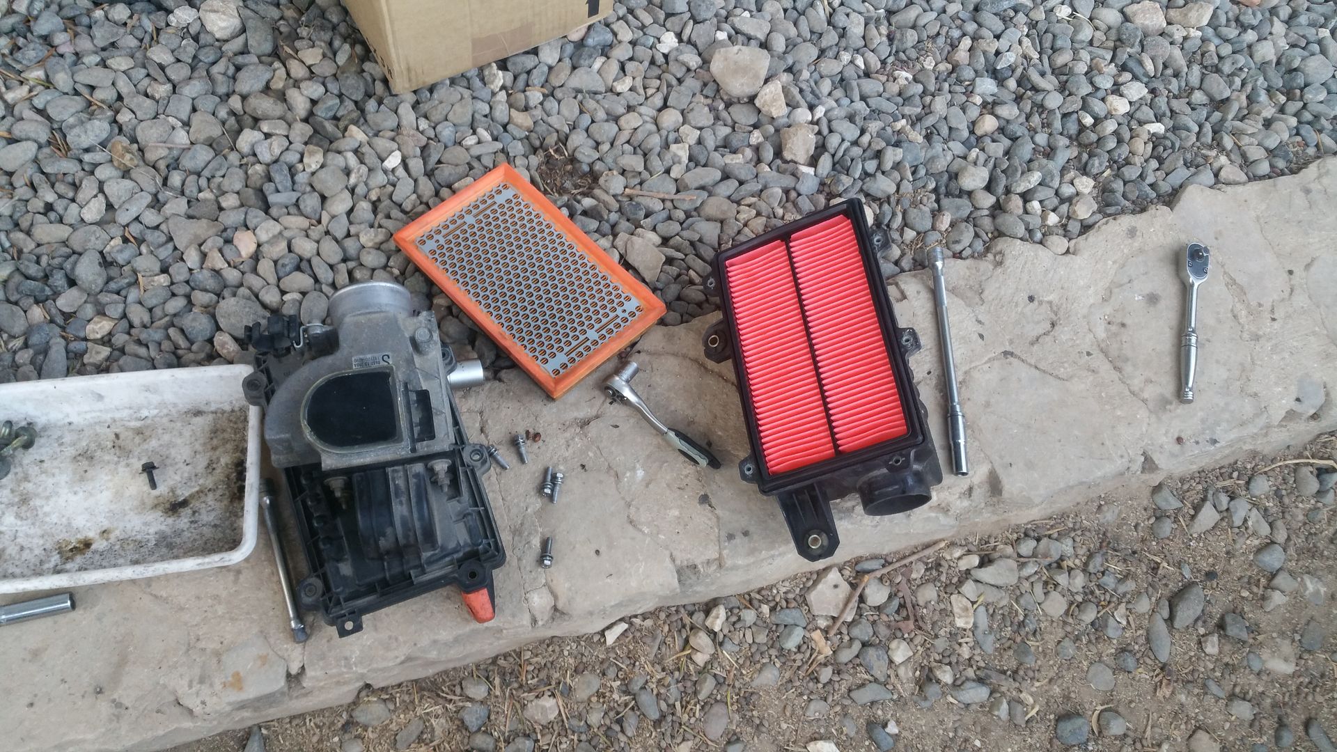

The AFM had done its stupid number 2 pin thing so sorted that and it now starts lol

GET THOSE GOD AWFUL THINGS OFF THE BONNET!!! Think they been stuck with some industrial stuff as they on well haha

Looks good for 500 Euros. At that money if you can get it to run you are onto a winner. Nice to hear that the bonnet vents are going. What goes through some peoples minds?

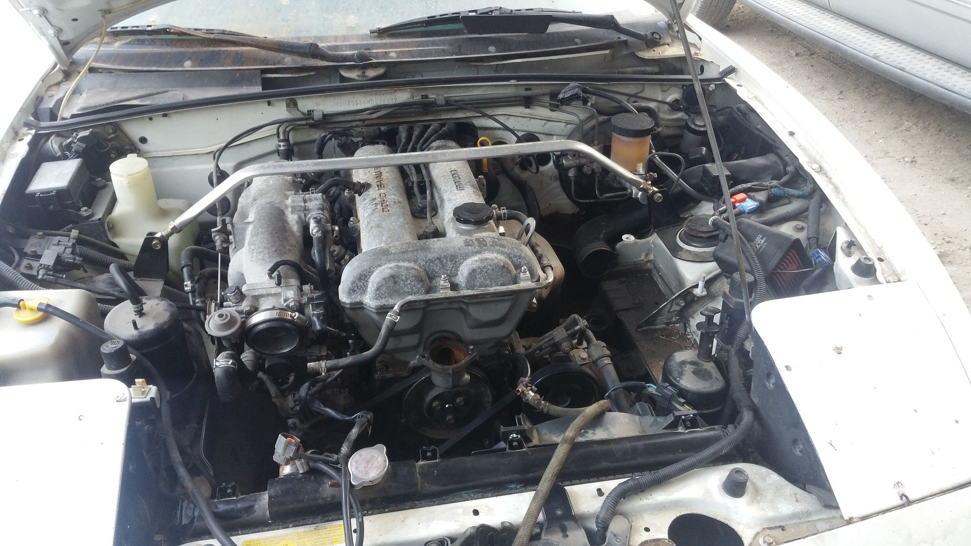

Just a small update with some other pics too, managed to get most of the service bits done today, just praying on the caliper rebuild kit to arrive today as Spain have bank holiday this weekend so basically everyone is too pissed or lazy to work till mid Tuesday haha
So for start off after FINALLY getting the correct water pump its installed:

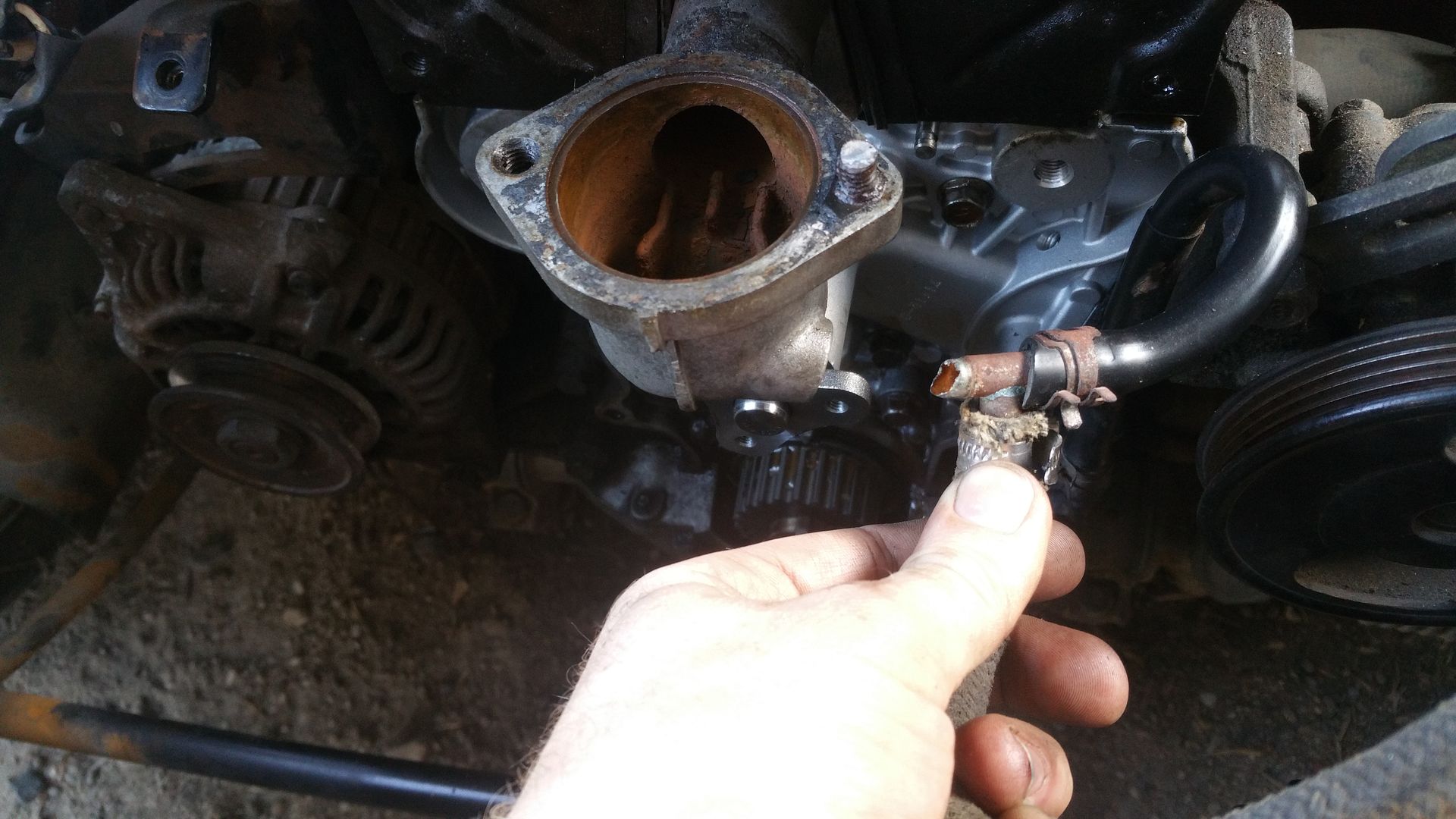

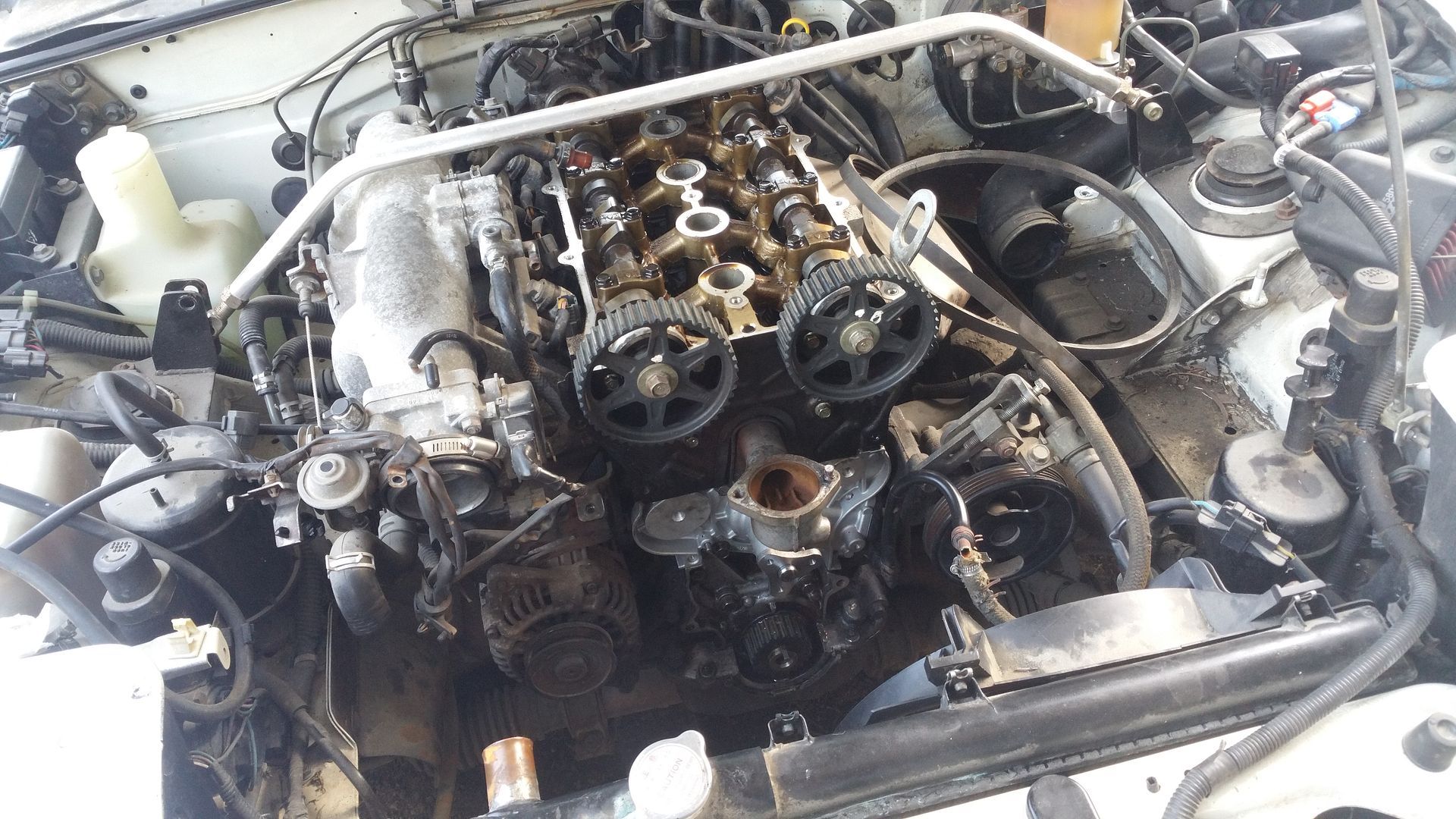

And here we have the typical Mazda fault that I will be fixing today:
Now all timed up after finding out that its been run one tooth out since its last change which was god knows when
All back together with Oil filter changed ready for the stat fix then add coolant and oil, new spark plugs in and air filter done so hopefully by the end of the day she will be up and running again just to await the brake repair

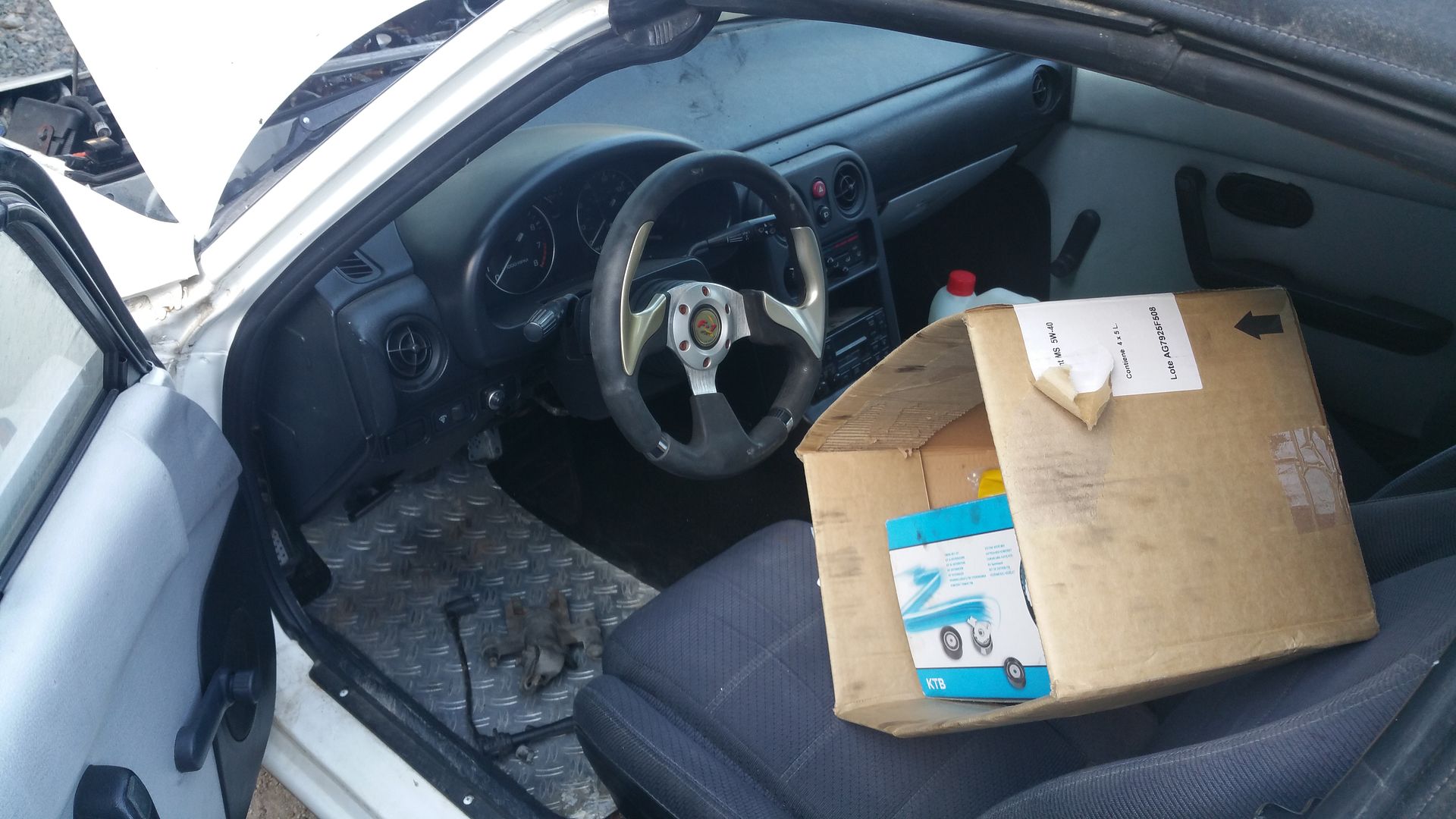

Here is a pic of the inside, this will change rather rapidly when time and money permits

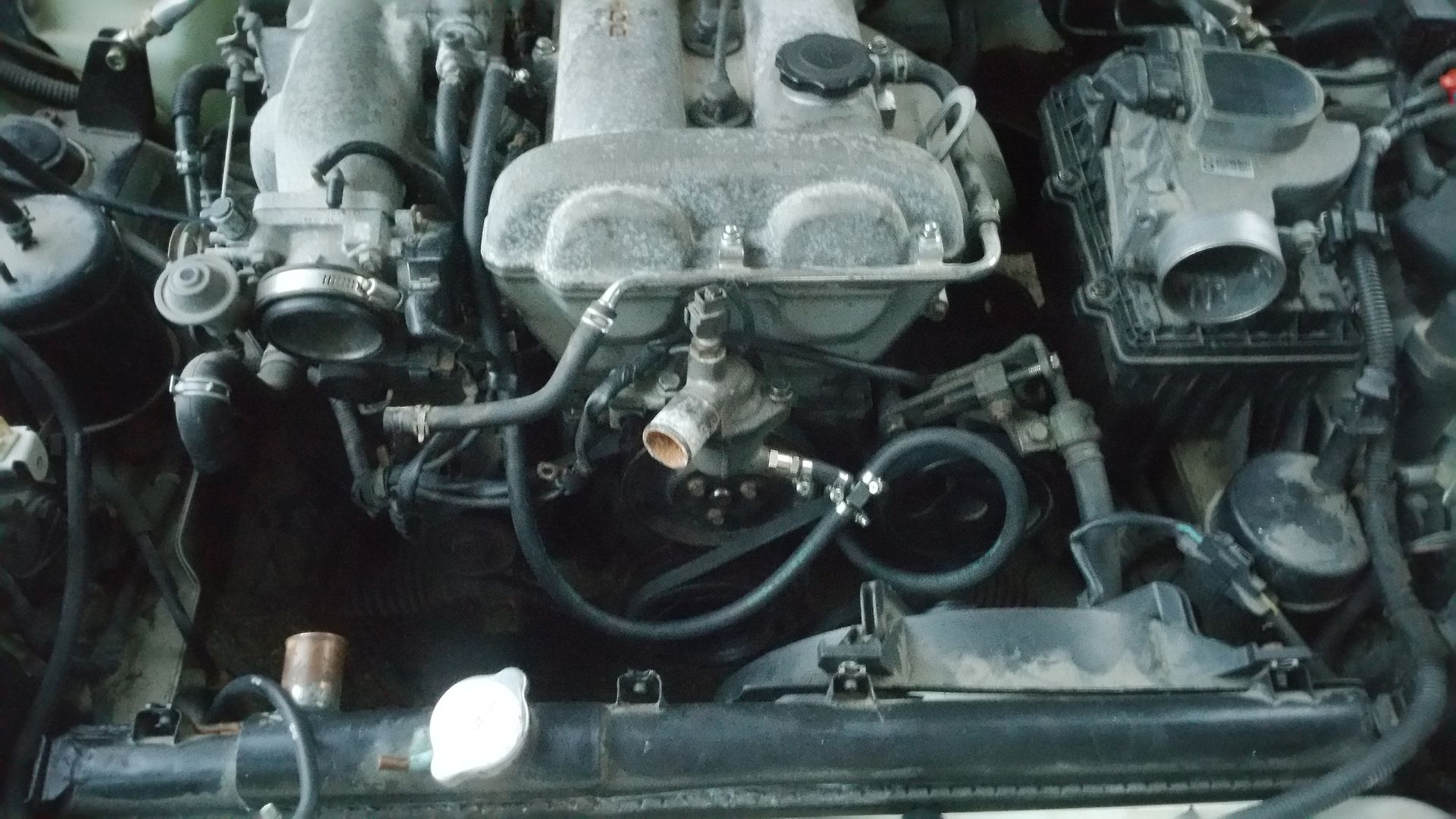

Here is next update

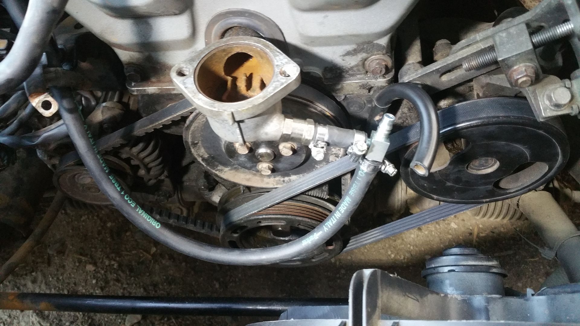

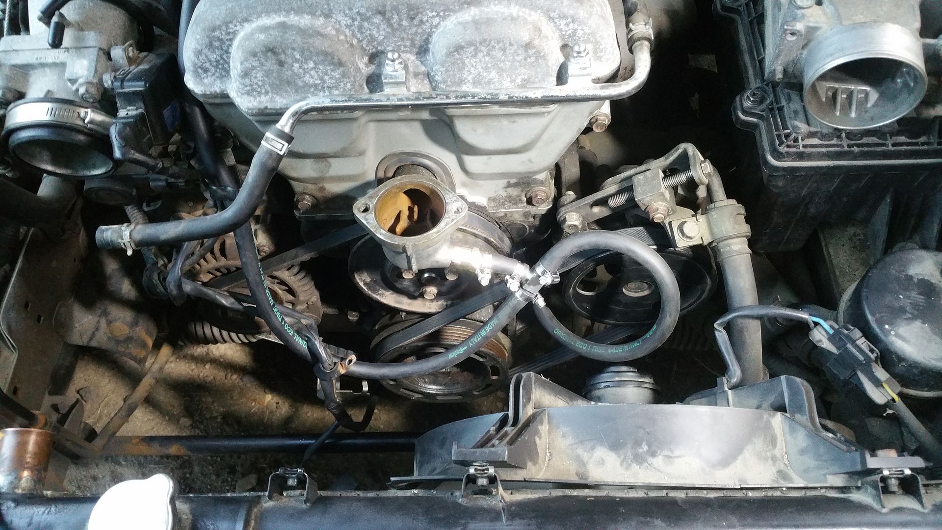

Fixed the stat housing and got it all together, started to fill with coolant but have a leak somewhere down the side of the engine, maybe where the water pump meets but not sure but run out of light so will investigate more tomorrow, just some pics of the work I did

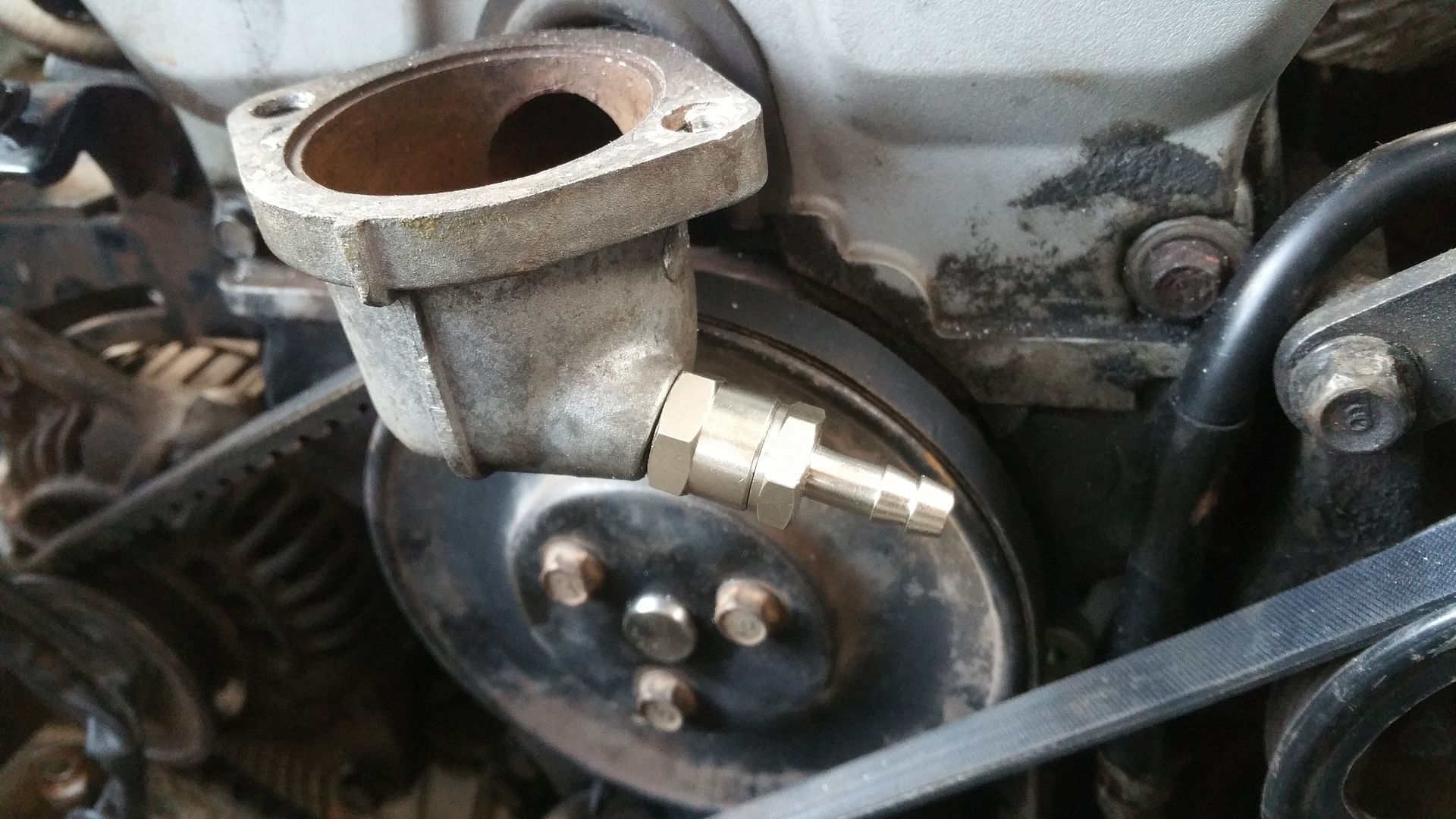

Things i used to fix the housing was as follows:
1/8 BSP Threaded tail end and 8mm t piece
1 mtr 8mm Hose
6 Jubilee Clips
Tools:
8mm Drill bit will angled air drill
1/8 BSP Tap
17mm Spanner and 16mm
6mm spanner for the tap unless yours is different size
Magnet and air to remove the particles
Straight edge screw driver
Also added extra was removing the broken stat housing bolt but that different thing lol
1st thing i did was run the 8mm drill bit through the side of the broken housing making sure it was straight and clean
Then used a 1/8 bsp tap to make the thread, again making sure it was straight to ensure a good thread is made
The using PTFE tape on the thread of the tail end placing it in so it looks something like this:
This Tail end was the only one I could get in short notice but you can get them on ebay here: http://www.ebay.es/itm/BSP-Taper-Thread-x-Hose-Tail-End-Connector-Brass-Fitting-for-Air-Water-Fuel-/121360796379?var=&hash=item1c41aacadb&clk_rvr_id=909427101640&rmvSB=true
Wants to be 1/8 bsp and 5/16 diameter for the hose
As I was adding more with this and the T piece I replaced all the hoses that joined and slightly re routed it
This was from the inlet manifold and extended to keep away from the aux betls
Now this is the part where my leak may be as the hose for the next line broke will replacing but again to keep away from the belts i placed like this
So all back together minus the inlet and top hose which I did but too dark for pics doesnt look too bad and looks pretty factory fitted

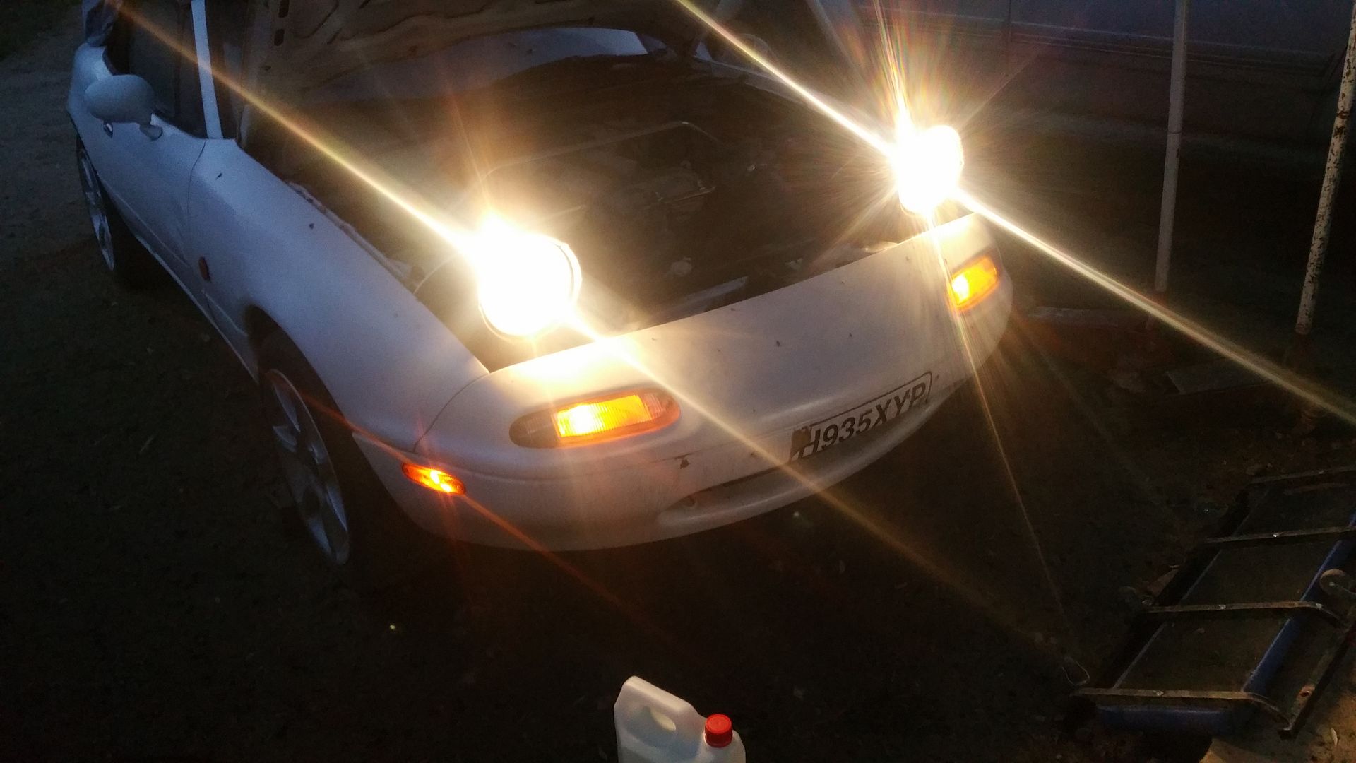

HI guys not much of an update, well in a way its not but the 5 is alive!
After fixing the 1st leak I got it all up and running to find another leak haha the clip that holds the hose to the stat housing was shot, so replaced that and we now have a nice sealed coolant system

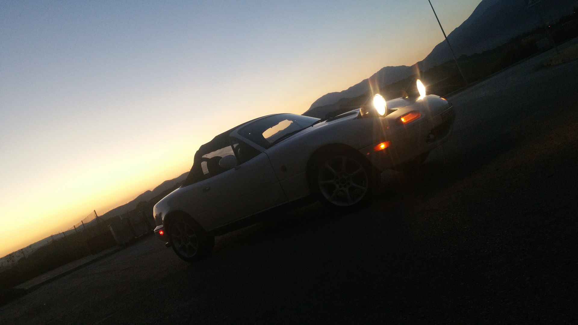

Here is pics just after I finished bleeding all the system up etc and before its well deserved bath ( 1st in over 5 years!!) And what a state it was, still not to my standards but better than it was
And then after a good bath and some well deserved driving, I found a good place near where I work and took some more decent pics :slight_smile:
Enjoy
So there we go so far so good…ish, still a long way to go before I can call her my decent 5 but the start has been made :slight_smile:
