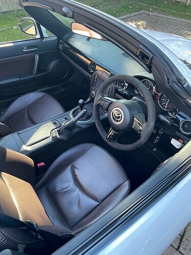

After this, came a mod I was not happy with. I changed the shifter for a cobalt short shifter. I have previously posted about this. I also installed a Likewise Daytona Pro shift knob.
The Cobalt short shifter is not a good piece of kit unfortunately, and I have reverted back to stock and also changed out the shift know to a more simple setup you can see in the pics below.
The Cobalt short shifter constancy buzzes and rattles and is tricky to get set up right. I did several mods to remove the buzz, but it never fully went away.

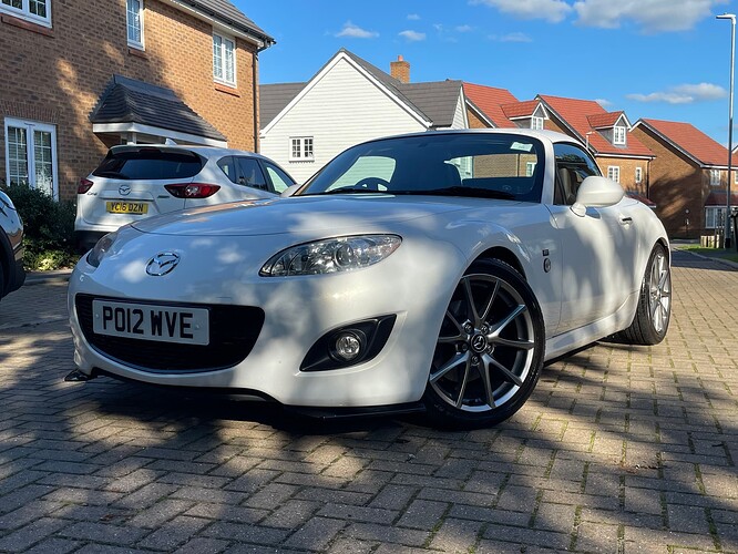

Now I would say this, as I am bias, but I truly think my NC2 must be one of the best in the UK. It is not garage queen, and could not compete with the 25th AE or Recaro boys and girls. But mechanically it is as sweet as a nut. It does scrub up well to. Have a look below.
