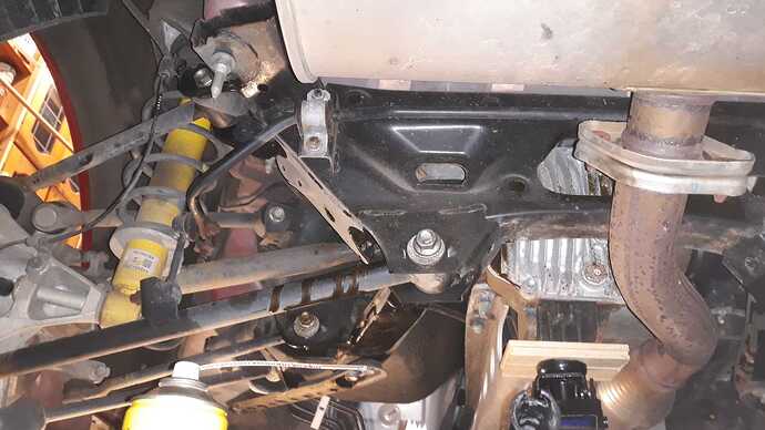

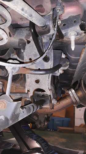

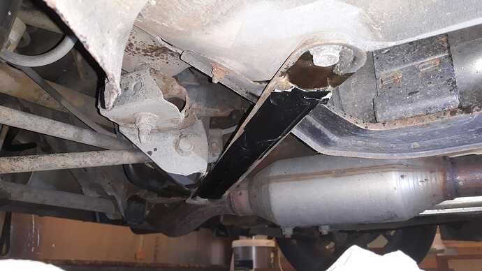

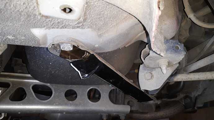

Added a bit more Dinitrol in normal vulnerable braces.
I had half an hour free this morning and squirted both the perforated braces, after sealing the perforations with gaffer tape for long enough to get the Dinitrol in and dried.
I also checked the penetrating oil had reached all the alignment bolts and nuts. I still can’t quite believe this little car is nine years old.

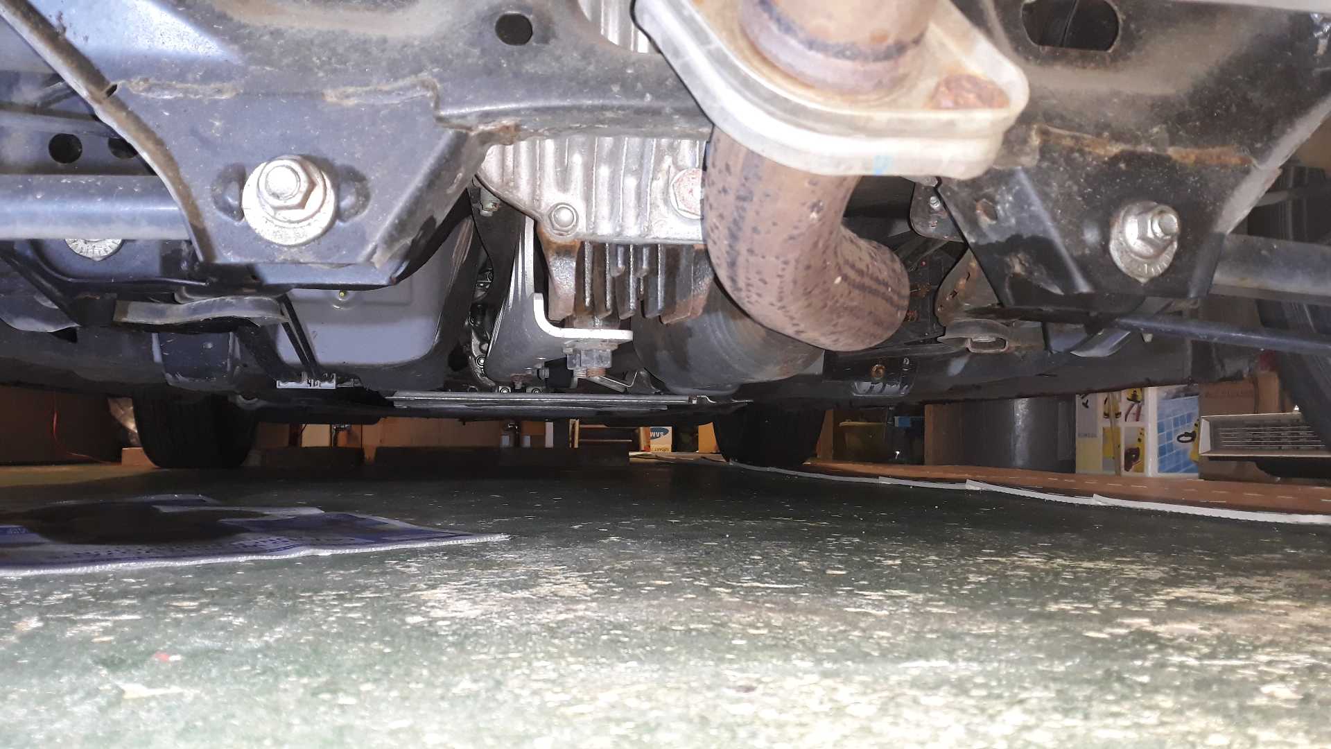

Wax injected the rear subframe.

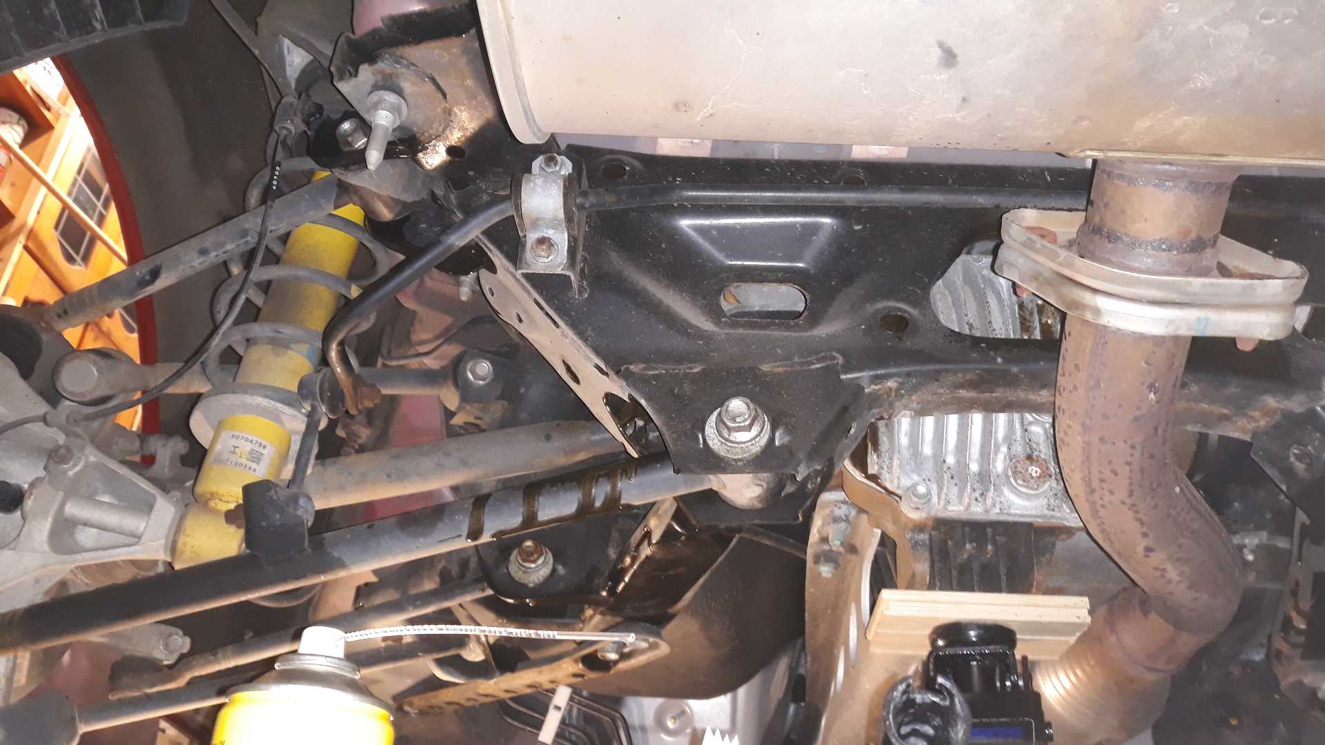

After a few days on IT duty I’ve been able to catch up on the car. I jacked up the back and made it safe with the axle stands before venturing further underneath.

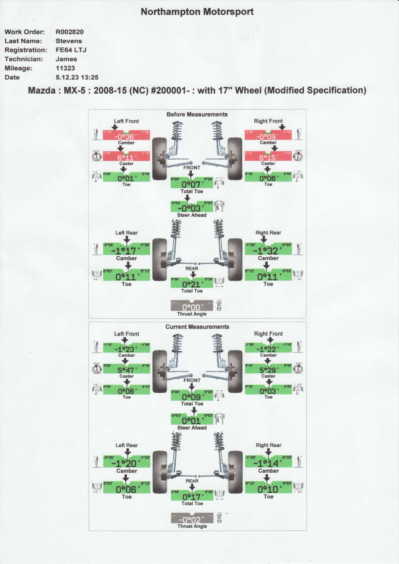

I notice both rear tyres are more worn on the outsides, unlike on my old Niseko where it was even across them. When I did the DRLs on the 25AE I found the driver’s side front was about the same as these two, but the front passenger side tyre wear was so badly uneven it could not stand up like the others and always fell over. Ergo, four wheel alignment is essential.
The two back tyres are touching at the floor but gapped at the top, and only 11k miles.
After that distraction I found all the best holes thoughtfully provided by Mazda to insert the Dinitrol wand and now the rear subframe should not rot from the inside. I repeated the gaffer tape trick on the two perforated braces I didn’t notice the first time.
While I was under the car, I refreshed the penetrating oil on all the alignment nuts, bolts, and inner surfaces where the bushes will be moving to and fro, and on the drop-links because I think one is a bit noisy.
Some pictures showing only a little bit of wasted dripping goo.

Straight away I could feel and hear the difference with the Contis while driving on to Northampton Motorsport where guru James updated the wheel alignment to a better, more modern setting, and reduced the already improved wander to almost non-existent.

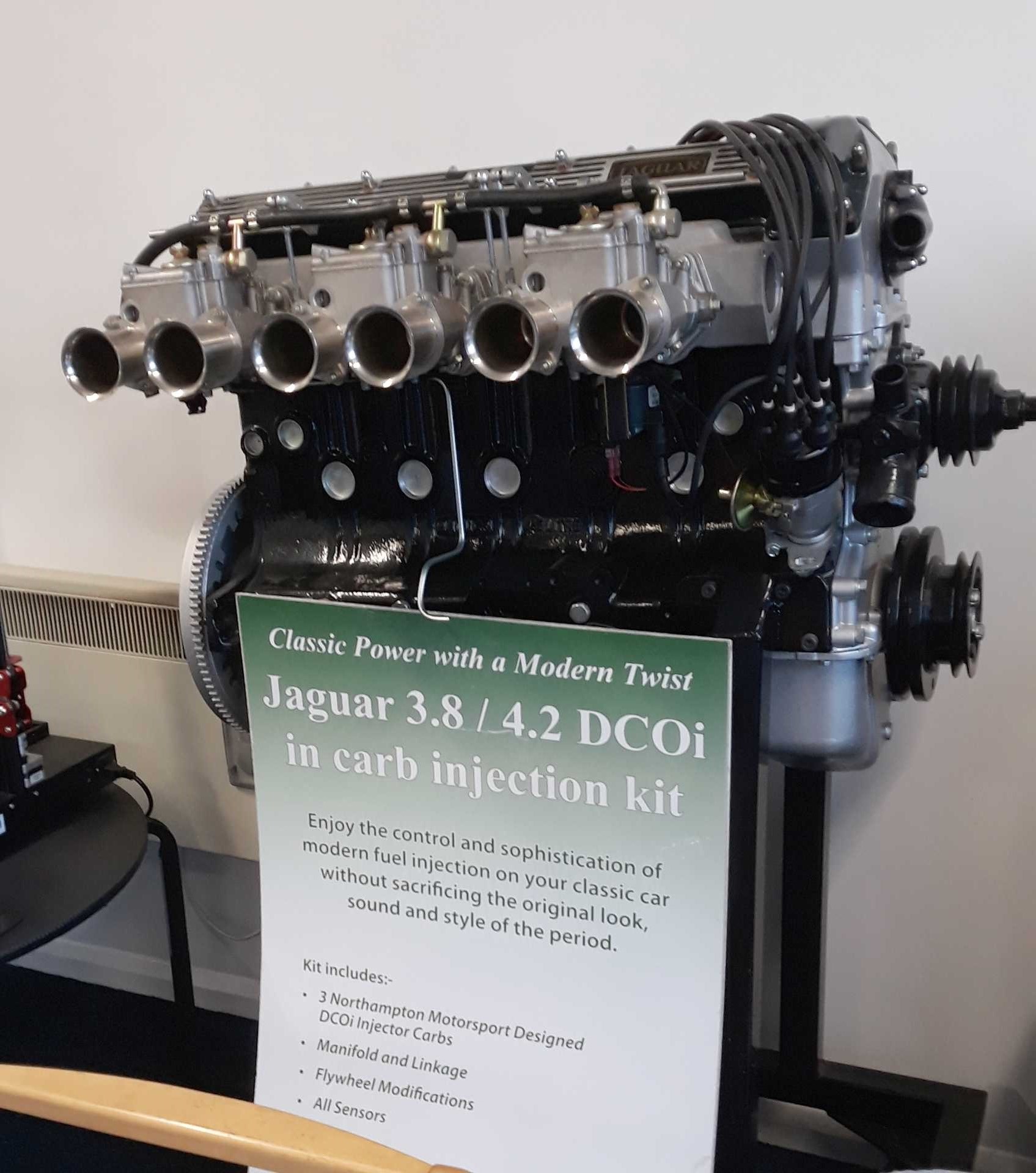

While I was waiting, listening to the tunes of dyno runs from the workshops, I sampled a pile of motor-sport and custom car and kit related magazines, and lusted over this Jag engine evoking fond memories from five decades ago.
Except the previous old-from-way-back-then standard enhancement of triple SUs has been replaced by what looks very much like a cluster of three twin-choke Webers. But hidden in, under and behind them is a full fuel-injection system. Truly brilliant engineering!

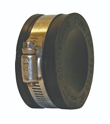

Can I ask where you got the 45mm bung? I couldn’t find as suitable one anywhere when I looked.
Of course, you need the 1.5 inch one.
DON’T get the 2 inch one as it’s far too big, (from experience).

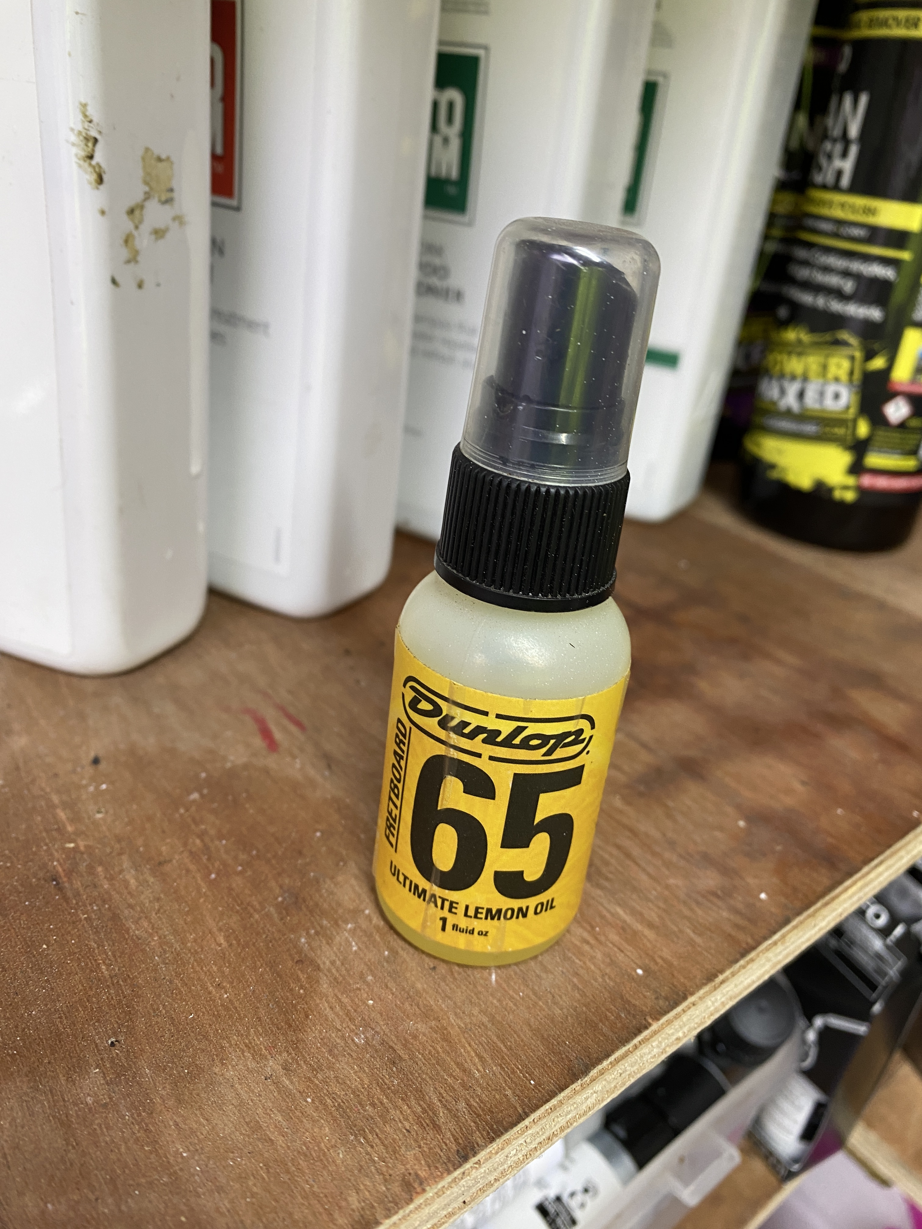

I must figure out how best to put more of a gleam on the fog-light’s black plastic surround.
I also re-affixed the front numberplate plinth more securely to stop it rattling.
Have you tried this??
I’ve seen that Jim Dunlop stuff used for smartening up the wood on guitar fretboards etc.
What tunes can the fogs play?
Interesting. I think I know where some JD65 is. If I can find it I’ll try it on some other smooth matte black plastic I have.
I was considering tyre black, but apparently most versions wash off and make a mess.
But then I’ve never used it, so need to be enlightened.
