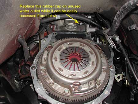

Is this it (found a picture on the net)
Blanked off hose

Sounds like cam covers off and cam sensor out

Thats the one and get standard type hose clip ( old style ,screw type0 and tighten it nicely.The original clips are hard to get back on and dont seem to have much tension on them ,being sio smal etc.Fuel line Jubilee clip is what you need basically Ah no need to take cam cover off as it wont help access.CAS ok remove and tippex the postiion of it for refit .Remove coil pack for easy of access. Took me about 1 hour to chip/cut it off and 5 minutes to put new one back on !!
