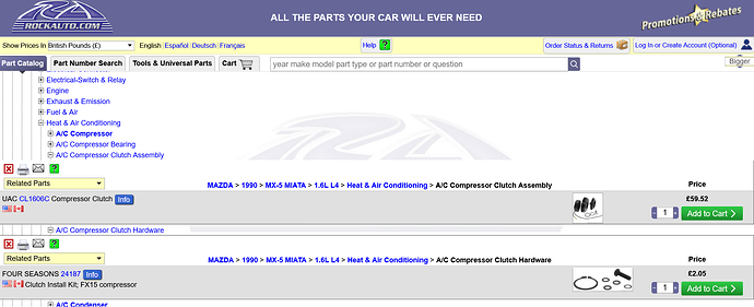

Can your mechanic repair the compressor, because Rock Auto list the clutch parts
Rock Auto say that will be £94 all in, with vat and duty, shipping, and here by May 10

The mechanic said to get parts, he was confident this will resolve the issue. I have ordered the parts from Rock Auto (£96).

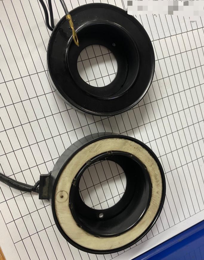

The parts received are not compatible with the existing AC Compressor. Should have got the car back this week…

RockAuto has asked me to send them the part number from the AC Unit so they can investigate their end.
Don’t know about kits, I see what RockAuto comes back with, might be tempted to buy a secondhand one from eBay.
